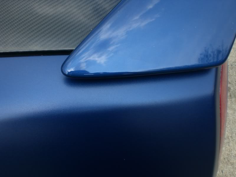

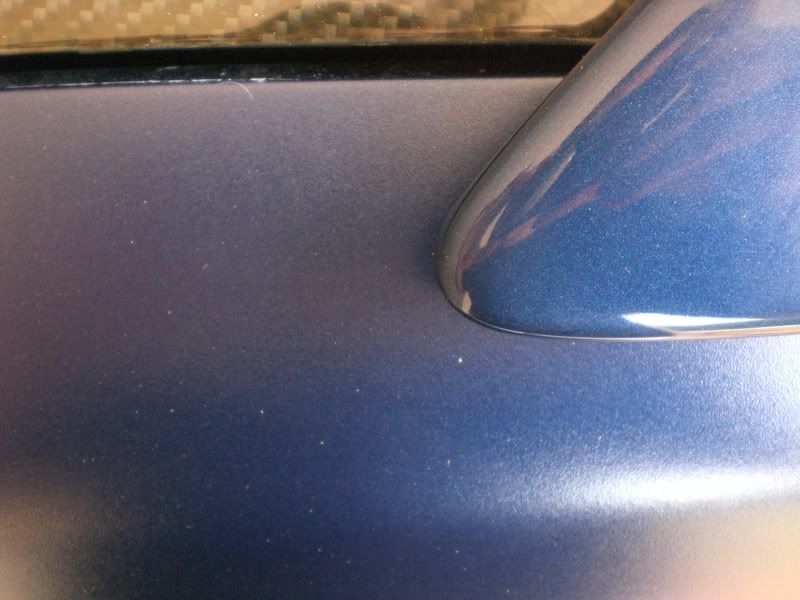

    looks like the start..mayb little shinnier?
    shows where i stoped the color and then cleard..so didnt do too much?

    If the whole car was that flat blue color, it would be cool.
  3. #43

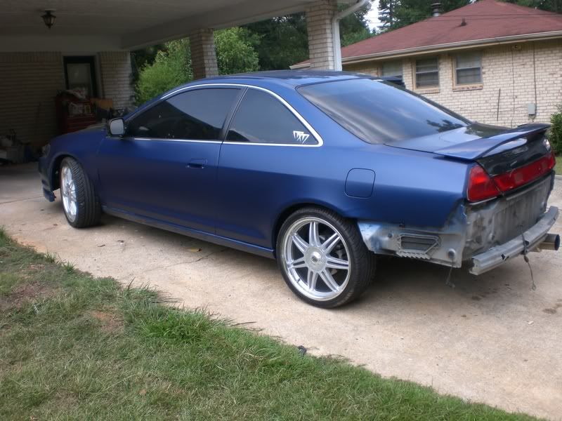

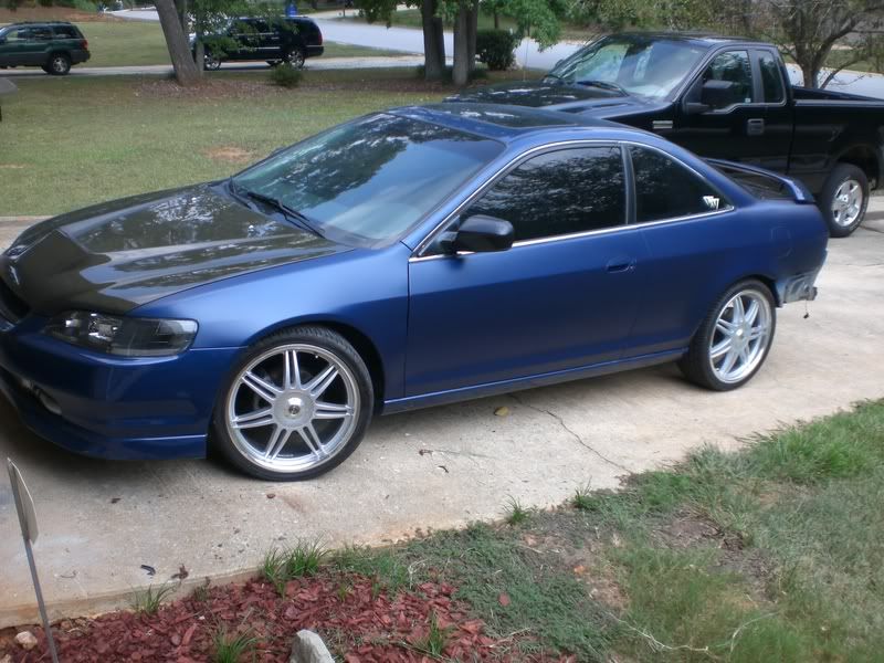

    ^ thats what im looking at.lol the bumpers,side skirts and roof are all slick and shinney now.. and spoiler
    haha

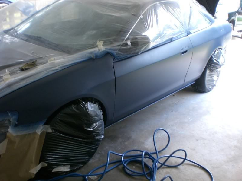

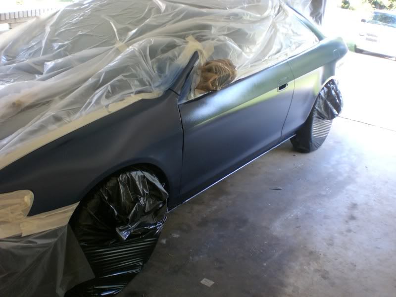

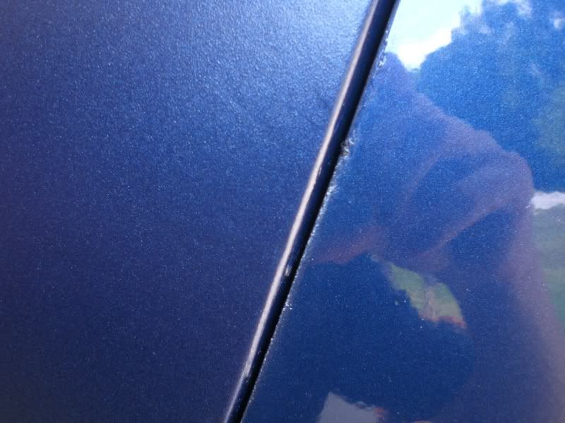

    sitting outside..drying..still kinda gummy;
    color dose not match..ha
    now this i did last night,no clear;almost the same apperance.

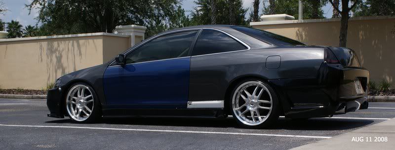

    i didnt take a before shot of my car with the new doors..but heres my old doors on his car.now driving around Tampa,FL,
    Guy drove down from Tampa to swap doors and get his side skirts put on.

    try putting more clear down, it looks like you are just not putting enough down for it to level out. also, how much CFM does your compressor put out. If its not enough then it will just sputter the clear and not atomize it correctly. Most HVLP's require atleast 7-8 CFM usually more. My DeVillebliss uses over 10 when i turn it up. Also check your pressure drop when you are spraying. If you set the regulator at 25 you may only have 18 at full depression.
    Hope this helps

    im using a Brut 10gallon 2.5hp compressor, its 125psi max..
    90psi 5.1...and 40psi at 4.1 (what it says on tank.lol)
    and have the gun all the way open 50max,,then running the reg.and gauge reads 25psi.then 40 when i was doing clear.

    turn your pressure down a bit, most HVLP's max out at 35. so i would try 30 especially if you have it all the way open. You may want to shoot a little less for the clear. I think you are just shooting too high of a pressure. If Bucky is close enough too you, you might want to pay him some gas money to come help you. I am further than he is. Or if you want to stop by the shop one day i can show you a few things. Some of the tips are hard to explain, and better to show in person.

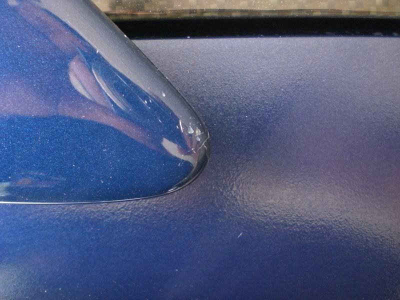

    this is what it turned out looking like after i buffed it the last time(last week)..its kinda hard to explain what it looked like..you can see from the pic.
    now when i go get some new clearcoat..would i just scotch gray-pad to scuff it up to reclear?
    Looked like crap..textured flat blue looked better than that...haha
  24. #64
    2,661
    Yea take a bucket of water, a grey scotch pad and do it while it is wet. And if you want get some PPG scuffing paste too, to quicken the process. and then wash the car down with some dish washing soap, let it dry tape off and re-clear if you didn't go through the base.
    BUt from looking at that texture, it looks as if you can feel it too. If so you might want to wet sand with 1k and then spray the clear. Don't bear down too hard and go through the base either, because I'm assuming your running low on the blue.
    Some will tell you to just scotch pad it, but the texture will still be there, and when you re-clear it you wont feel it but the clear will maginify the texture so it will look as if it is orange-peeled/dry sprayed.
    Good luck.

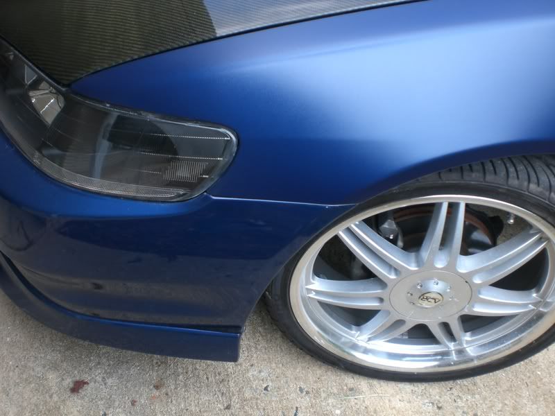

    here are some pics i took...to kinda show what im working with..
    *note bumpers,spoiler have not been wetsanded or buffed and still look decent...
    Pass. side,NO clear, pretty textured..
    Drivers side.3 coats of clear,minimul texture..
    Quarter and rear bumper comparsion..

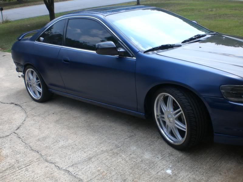

    Sorry Bucky and everyone else;I got bored and decided to try it..
    -well i got gloss,BUT HELLL load of Orange peel.I MEAN HELL alot...ill be having fun blocking this out by hand tmr or when ever...
    Used the Smart-4:1 with medium activator..
    this is about 5coats so i dont go through sanding all this out..ha
    **dosnt even look like 5 either**

    hey dude, play around with your air settings on the gun, it seems like its not atomizing correctly, and also, what kind of reducer are you using? i got some clear and reducer that i will sell you if you want that i got left over from my paint job when i was spraying at the spray glo. send me a pm if you want some more help, ill be in suwanee this weekend if you want me to come over and help you. also, what gun are you spraying with?

    Ya i tyred differnt settings each coat.ha
    But no thanks i have almost the full gallon left,and most of the activator.it looks alot better out in the sun.metallic shows really well. i just have to buff it to slick it out now.
    This mainly was a CHEAP spray to have 1 color car instead of silver doors.so i pretty much got what i needed out of it.
