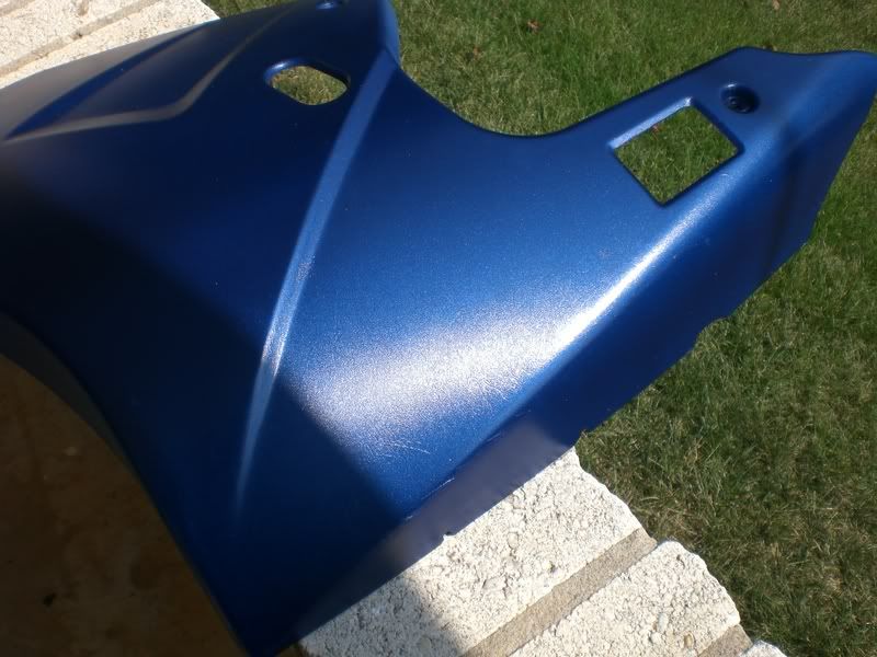

    I just sprayed a test panel off my pocket bike..it still has texture but not as bad..and shine..with 3 coats of clear..and 3 coats of base.. ill post pics in a sec..
    2,661
    explain this texture. does it look like dry spray or like an orange peel effect? Maybe your spraying at too low a pressure.

    this turned out alot better than the car..but still has texture and not laying smooth..

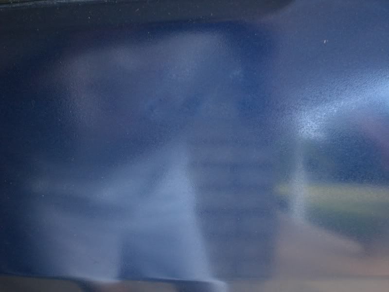

    this is what it turned out looking like after i buffed it the last time(last week)..its kinda hard to explain what it looked like..you can see from the pic.
    now when i go get some new clearcoat..would i just scotch gray-pad to scuff it up to reclear?
    Looked like crap..textured flat blue looked better than that...haha

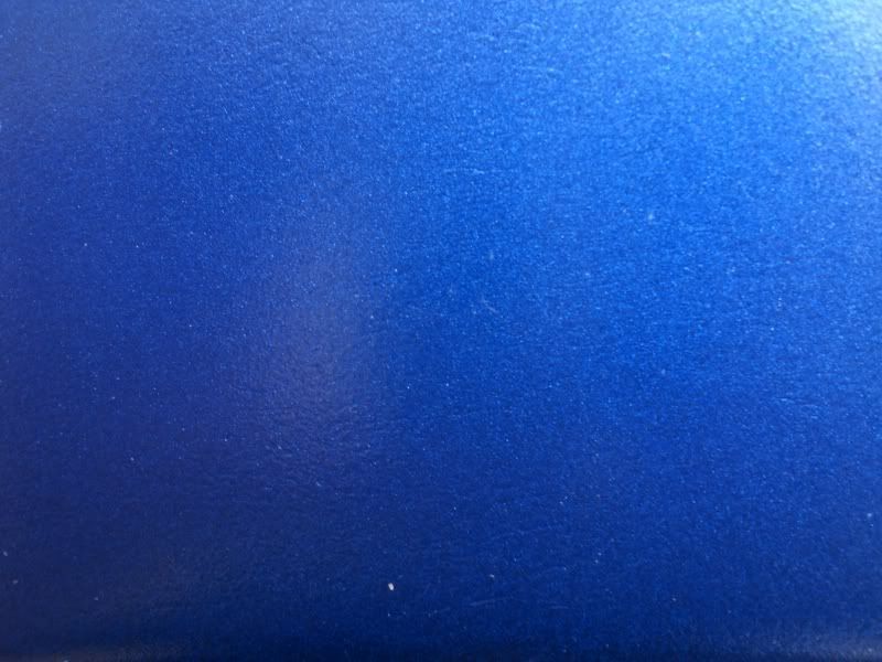

    ok dont laugh..its ghetto..but it works.surprisingly almost no trash?! but then again still looks like shti..ha
    This time i redid the drivers side; this side i previsoly buffed..so i 600G wetsand since i pretty much was already through the clear already to make smooth..cleaned up..then sprayed..
    3coats of blue.this time i lightly dusted it and held gun little farther away to reduce paint droplet forming. base looks much better than other 2times i tryed not AS much texture.still dull and no metallic...now its all on to the clear...
