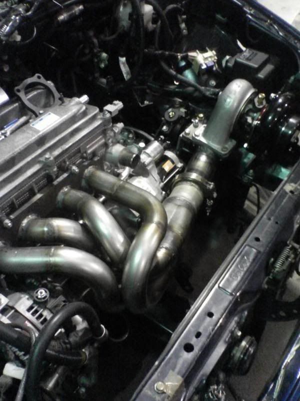

    Finished manifold Photos on Page 2:
    Here's a sneak peak of what's to come. It was finished a few days ago. The guy's do good work.

    Looks good!! How much longer until estimated completion of the project?

    Quote Originally Posted by BLK JDM
    ya know, that's an answer I'd like to know myself.. there's alot that goes into this, I'm not the only one who has a hand in it, so scheduling others in to do their part seems often difficult. I shouldn't be longer than 2 months to have it broken in and ready for some beating. (I feel like I am being a little generous with that time frame, it technically should be shorter..), so we'll see.
    Most components are assembled and much of the work will be just installing parts and tuning. But a few things like the intake manifold, oil pan and fuel system need to be finished before we can drop everything in. The motor in the picture above is just the test motor for the purpose of measuring and fabricating parts in the bay. The "built" motor is ready to be dropped in when ever we get the other parts fab'd up.
    Quote Originally Posted by SPOOLIN
    thats looks kool although seeing your manifold makes me think you could have gotten a garret/tial turbo with the vband exhaust inlet and been a first to use that design and system.
    in the end we are planning on using 3 or 4 vband clamps (one in the above picture) and 2 others on the down pipe.... we had considered welding a clamp on the a/r Discharge but I think we're going to use a flange instead.

    You're going to be severely disappointed with that GTK... they're momre for show than go... =[
    On a side note, that v-band inlet exhaust housing is gangster... any big advantages to them besides being able to pivot the turbo?

    Quote Originally Posted by ct9a gsr
    Thanks!
    One big advantage of using the V-bands is the dis-assembly process of the entire turbo system. After disconnecting the manifold from the block, there will be all of 4 or so more clamps to disengage and everything will come out. It will make it that much easier to interchange components if needed.
    As far as the turbo goes, I'm sure we'll be fine, I have no problem replacing it, if need be.
    Well you can make a much smaller housing flow the same amount as the conventional square housing. Could possibly see an increase in spool. You can also pivot the turbo but everyone knows.... pipes are round for a reason

    here's 2 quick shots of the finished manifold. I hope you like!
    Out of the car:
    Partially installed in the car:

    Quote Originally Posted by Complication
    Out of the car:
    Couple suggestions for the next one. The collector diameter is way to big, it would have been better if you had made it with a 2 1/4" collector to keep exhaust velocity up. Also the transition into the turbine housing the not the most ideal, in an ideal world you want to have atleast 4" of straight flow into a turbine section. Lastly the wastegate should never be mounted at a 90 degrees. Ideal would be a 45 degree or less split, think Y and you get my point.
    All in all it not bad, but i think there is room for improvement.

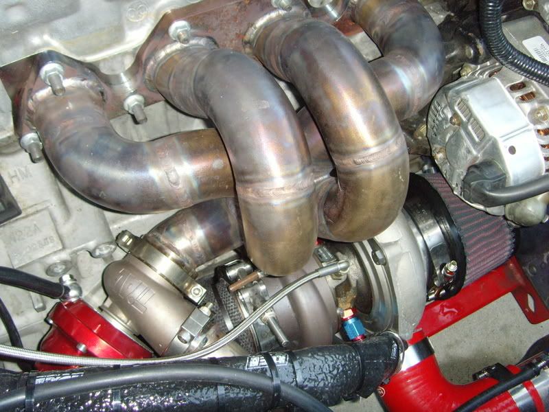

    wow. very critical analysis.....anyways, the Vband Tial housings are pretty sweet. just thought I'd show what I've put together....
