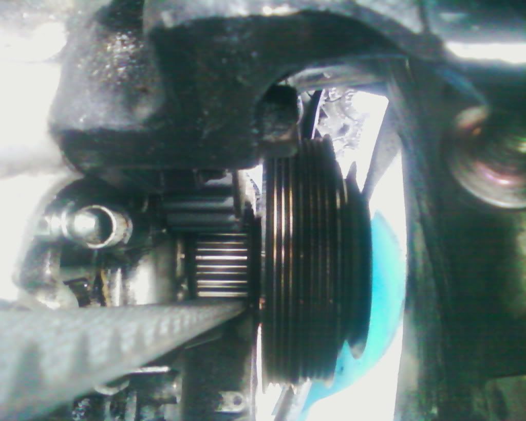

    This is what I have
    .... It's lined up
    .... This is not
    PROUD SUPPORTER OF BAM-TECH WTF?
    Southside Ridin HATCH
    9,812
    White line is TDC
    9,812
    Or whatever color it is.. Its the SINGLE line for TDC
    *NY Driver* CeOTiO8's Avatar
    In your girl
    1,044
    Yea that's where I have it... But the cam gear shaft or whatever that shit is called right now is not lining up... FUCK this SHIT .... Your coming over tomorrow to help hoe so don't make plans lol

    hey, look at the cams withe the valve cover off. Near the cam gears, there should be two little holes in the cam caps, and 2 holes in the cams. Stick a roll pin or a skinny screw driver in each with both lined up.(BTW that is the only way they will with the holes in position.)
    Also, having a lower timing cover would be helpful for getting it in TDC, but take out the number 1 spark plug and put a long screw driver in the hole and make sure it is at the very peak. Then put the belt on, spin it over about 1.5 times and tighten the tensioner while the slack is out. Then watch your screw driver go up and down and make sure you have it set to where they line back up after a couple of turns of the crank.
    GL

    take the pulley off..... there are 3 marks one on each cam and on on the oil pump
    line cams up.....loosen tensioner.....stick drill bits in the cam alignment holes.... wrap belt around cams and work it down to the crank.... that way you align only one mark at the bottom..... snug the tensioner almost tight..... bump the tensioner pulley with a rubber mallet so it takes slack but doesnt lossen again..... lock the tesioner down.......DONE

    set cy1 to tdc and set with the notch on the oil pump

    I went today and fixed his timing. Spot on!
    cranked it up.. sounded horrible.. He said it been sounding like that forever and it was normal.. I Told him the Motor is TOAST.. shit was Knockin and that is NOT normal..
