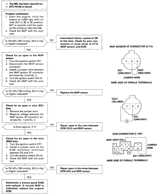

    alright so i got my car running but its throwing some codes..
    - P0108 Manifold Absolute Pressure (MAP) Sensor Circuit High Voltage
    why would it have a high voltage signal
    - P1337 Engine Speed (RPM) Fluctuation Sensor No Signal
    && wtf is that ..
    HELP plz!..
    thx

    P0108 odds are u have the wrong plug hooked up to it or its blown.
    do this and your problem should be solved

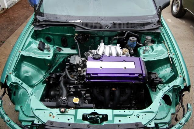

    and update i pulled the VC off the and the head is filled with water... its all milky and shit
    but the car doesnt smoke..
    u got a major problem. whats your coolant levels looking like.

    and it gets up to half way pretty quick.. but it doesnt get hot..

    would it be a cracked head.

    bad headgasket......

    cant be bc it would be smoking due to the water being on the pistons

    Lol.... did you route your coolant hose to the top of your valve cover?? jk. Sounds like a headgasket issue. Most of the time if the oil is mixing with the water it blew towards the oil passage side not the combustion side, so yea you may not be smoking. Is it skipping??

    You prolly got the map sensor plug mixed up with the TPS.
    lol. ummmm.
    juss sayin bc i had a blown headgasket on my DA before and it would smoke pretty bad..
    but id did figured it would be the head gasket.
    and naw its not.

    Have you have the motor apart? Or did you get it this way?

    Sounds like hg to me also. But there is a possibility of what QWK D16 said. Not as common on Honda engines but it does happen. May need to remove the head and see what you have.
