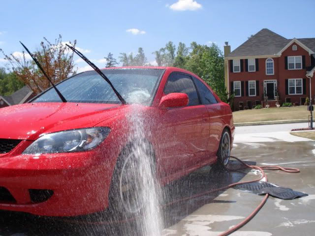

    1. Wash and Dry your car...

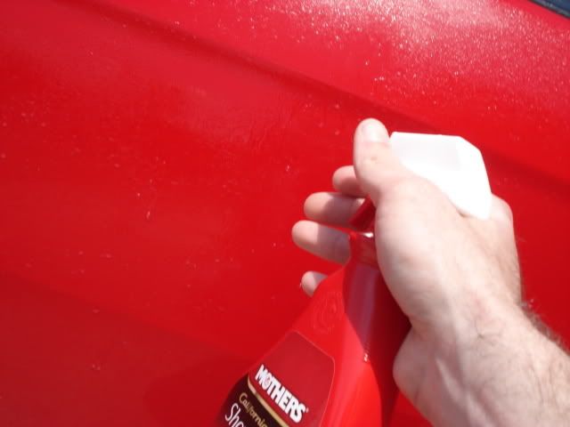

    2. I attempted the Claying part in sunlight on a warm day... id do it in the garage though. Make sure the paint is not hot. Apply the Mothers instant detailer that comes in the kit. Only do this process one panel at a time.
    When using the clay make sure it never hits the ground or gets any dirt on it. Using a back and forth motion, do not press hard. you can hear the contaminants being removed. keep spraying when necessary to keep the surface wet.

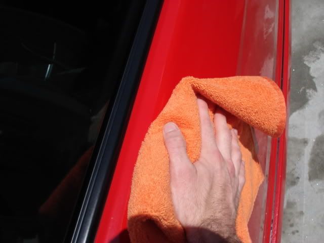

    3. After the panel off done, use a soft terry cloth... in my case a hand towel lol. Firmly press down removing the spray detailer. Replace your terry cloth with a dry one if you need too.

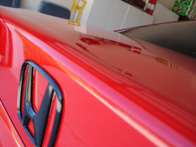

    4. Fold the clay bar over and repeat steps 1-3. Now it looks a little better...

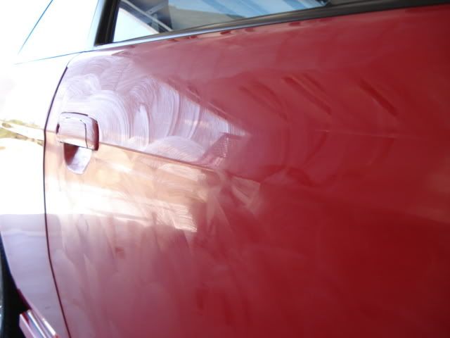

    5. Not done yet... Finally i decided to pull the car into the garage. The system comes with a small bottle of Mothers Cleaner Wax. I forgot to get new pads for the buffer so i did this with a small applicater pad.
    6. Of course you all know how to wax a car... Use small circular motions... if you don't know how, go watch Karate Kid....

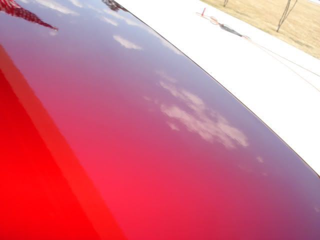

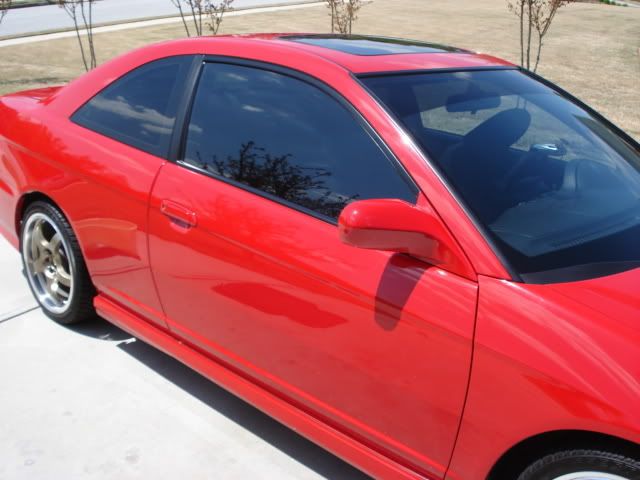

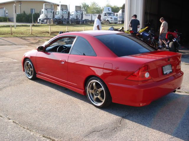

    When your all done you get this....
    Hood.... look at the clouds :banana
    The End
