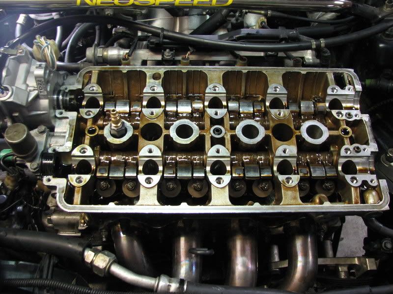

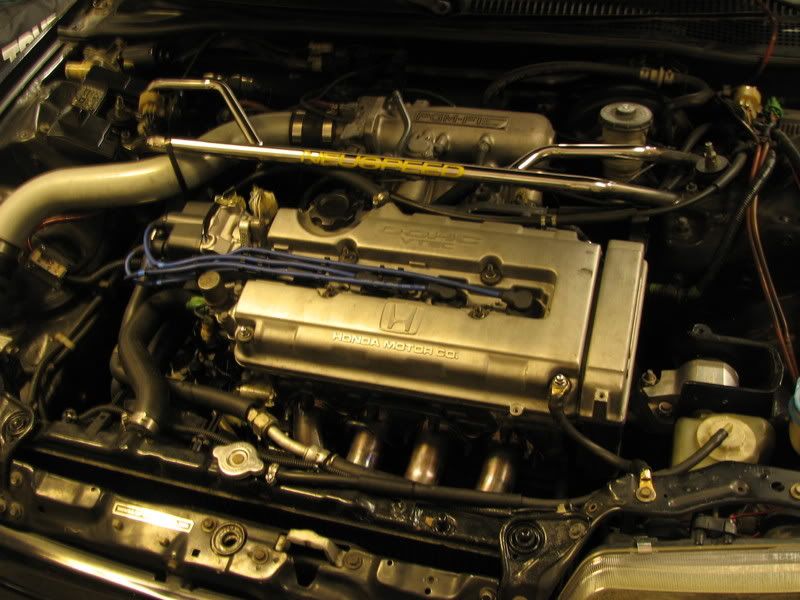

    Started on the cam install last night.
    One last look...

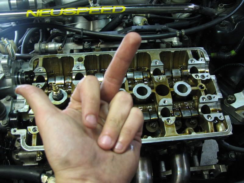

    ^^^ Satan himself. Sum of you guys might know what i'm talkin about

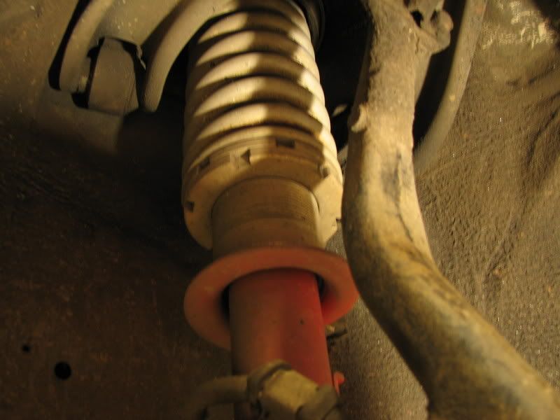

    Alright, there are my dad's struts and coil overs. We have... no idea what they are. The struts are white and they almost look like they say "AK" or "AR" on them.... And the struts are this red-ish color...Any ideas?

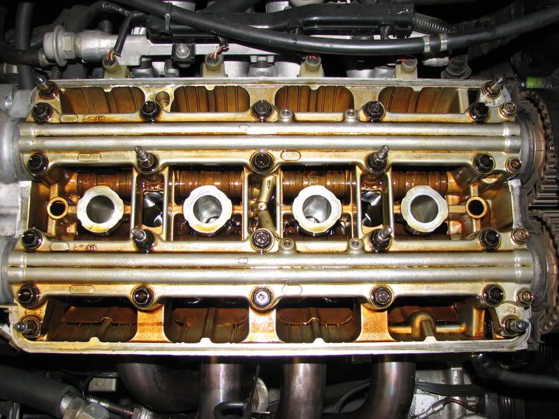

    Day 2 (few days ago)
    almost naked

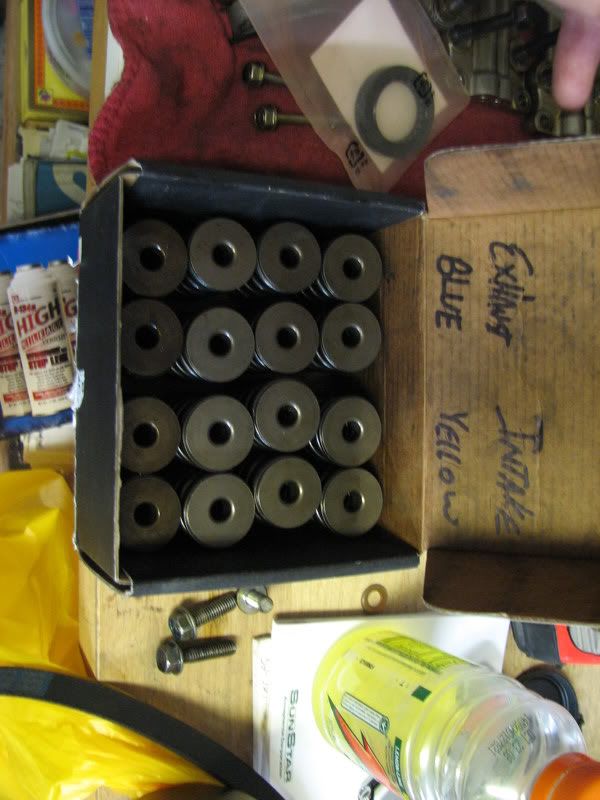

    ^ ITR springs on deck!

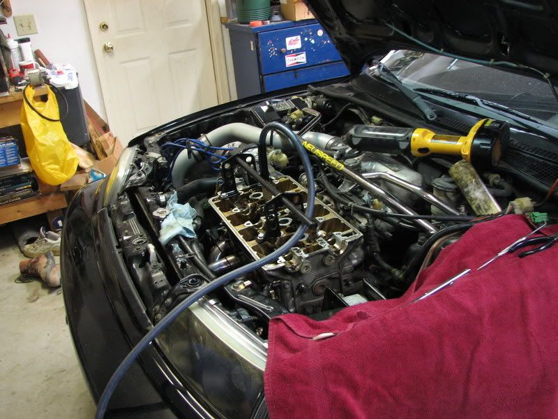

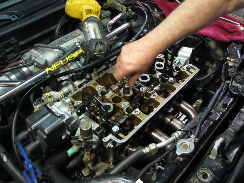

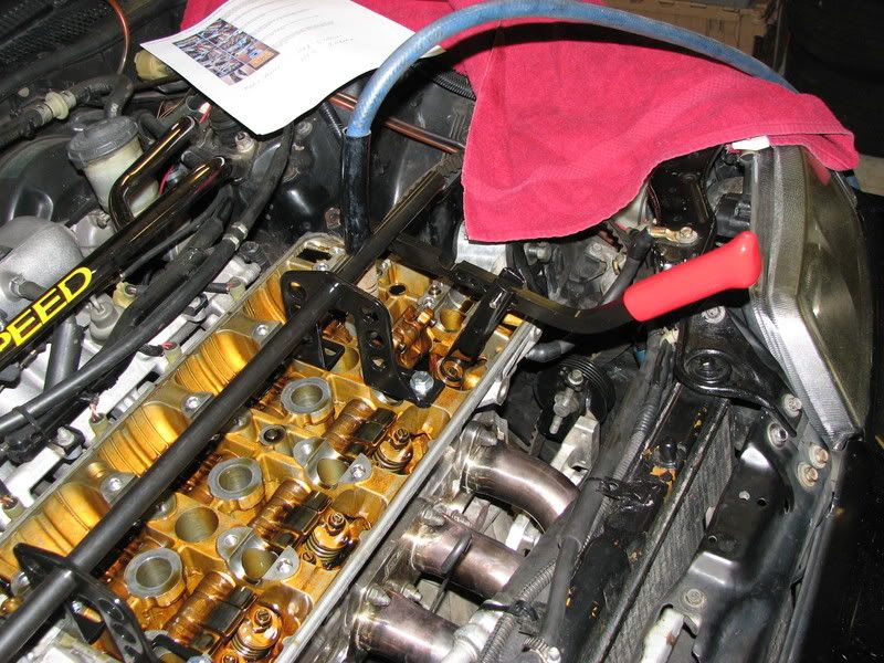

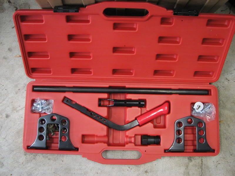

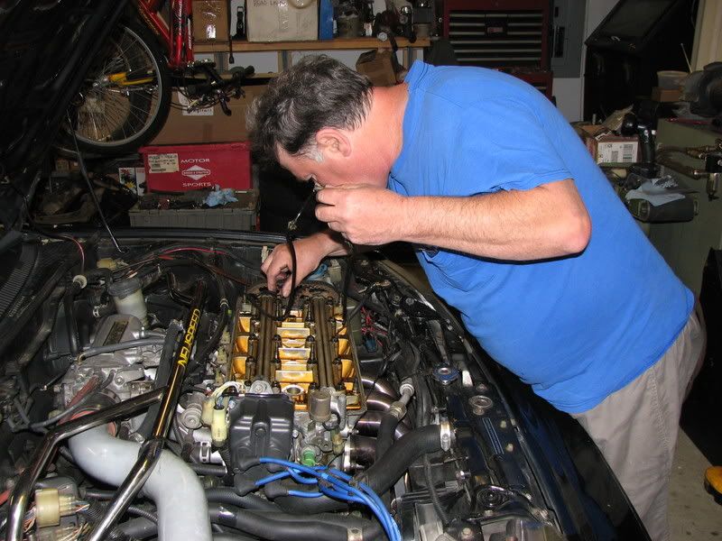

    Tool used to install and uninstall the springs....and here's how it works:
    the bar is used as a support, and you push down on the spring, use a magnet to take the 2 valve locks out, and then take the spring out. the put the spring in, and put the valve locks back in.
    no pics of us actually taking a spring out, cause the air compressor was going off and on, and if it cuts off then ur basically ****ed. plus, the fawking vavle locks are so hard to get in on the intake side. we lost one about 3-4 times, and one time i actually went down into one of the holes that goes to the bottom of the motor. we thought we were gonna have to take the entire head off... lol it wasn't untill then, that we decided to plug the holes w/ shop rags, haha . lesson learned for the next cam swap

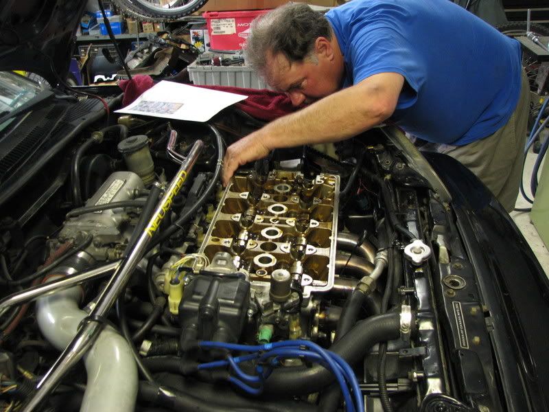

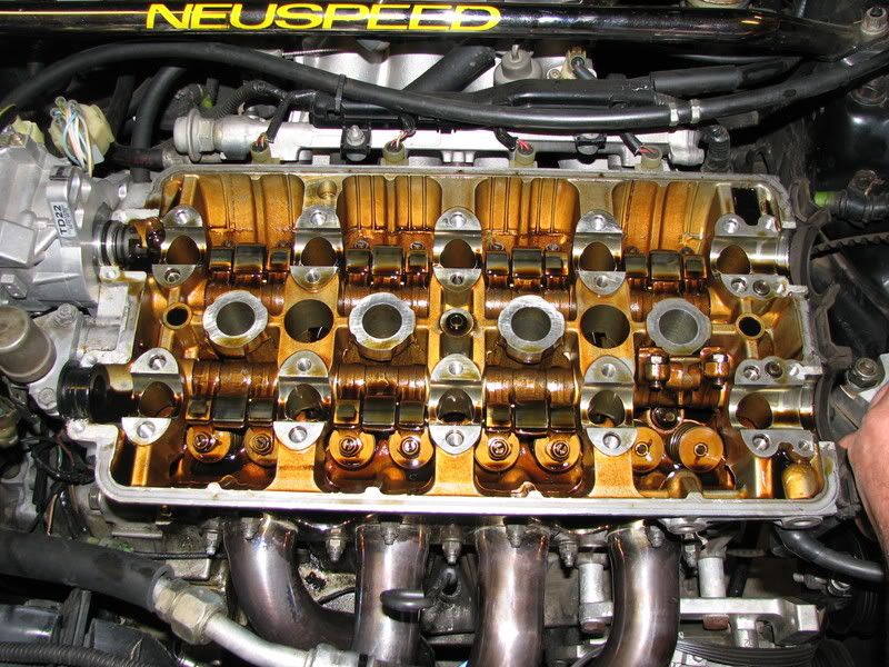

    Springs in!!!!!
    and yes, it was a biitch
    Side note, i dont think many people actually swap the springs and retainers... well, if they do, then they probably just swap the exhaust side, because they're really easy. the intake side takes alot of patience, and defanitly aggervates the fawk out of you.

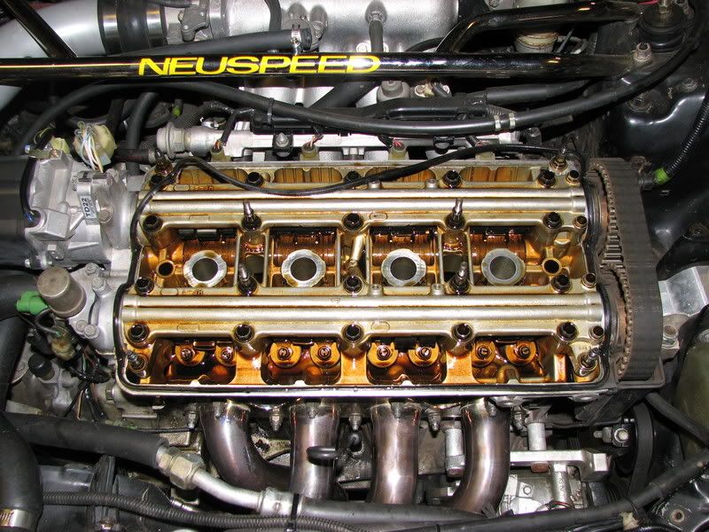

    we completed day 3 the other day, but due to IA being down, i havn't posted those pics, just these...
    i will post those pics tomorrow.
