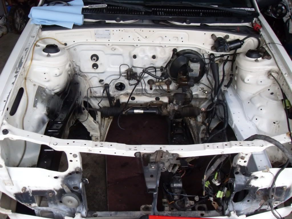

    aye bro .:Stirfry:.'s Avatar
    4,344
    when you gunna paint the bay
    ATL DAsquad Member #9
    5,717
    i still dont know if im painting it or not. if i do it will be black.
    Certified Gearhead 94ej2's Avatar
    Mobile, AL
    347
    do not paint the bay. LEAVE IT WHITE.

    it pretty much has to be painted. i dont want welds just sticking out in the bay. it will look like shit once the new mounts are in if i dont paint it.

    I say paint it white, paint the block black. Also, why not just buy the Hasport mount kit? and while your at it, hit up chasebays for a nice tuck.

    custom mounts..hoping to get them mocked up tonight. maybe even weld them in. i have a 50 trim but i dont see it being boosted. its going to be hard enough to get it just to run well. lol

    its in by itself! need to finish a few things on the front and side mounts but the rear bolts up perfect!
    rear
    the problem mount

    tomorrow i hope to at least get the front mount drilled and bolted. the hard one will be the passenger side.

    doesnt look hard at all. to get some plate metal from lowes or homedepot and make it from scatch. i wouldnt waste my time welding in that super thin stock junk.
    5,717
    Quote Originally Posted by 94ej2 View Post
    the white piece is an oem 626 bracket. it will hold that kl no problem. gonna bolt and weld for added strength. mikes probably going to make something to fill up the gap between the wheel well and the bracket.
    still undecided if im going to run the trans mount or not. i dont really need it.

    the passenger side, is the 626 mount itself, or the 626 bracket also? And are u using the BF crossmember down bottom.
    and is the passenger side mount on the trany bolted down? did any of them line up?
    what mount are u using for the rear bottom tranny mount?
    5,717
    Quote Originally Posted by JITB View Post
    the pictures should explain most of it..lol
    stock b6 crossmember, rear mount bolts up perfect. the front needs a little adjusted but will work. the passenger side motor mount is the hard part.

    i was saying is that the 626 bracket or is it just the 626 mount? i cant tell. i asked because the mx3 passenger bracket bolts up differently to the chassis..
    5,717
    the passenger side mount is a 626 mount and mount bracket. do you think the mx3 one would get rid of that gap?
    ALL CAPS JITB's Avatar
    20,772
    Quote Originally Posted by DeeAOne View Post
    yea man thats what ive been tryin to tell u..lol the mx3's bay and the bg/bf engine bay are identical. And the mount bracket on the passenger side of the mx3 gs mounts just like the 4cyl does, just the bolts that connect to the motor are different. The 626 is a whole different setup.
    what are u using ont he passenger side as a mount and bracket?
    try the 323 bracket on the driver side, and a mx3 v6 passenger side. If the driver side acts funny, try a bg driver side.
    You might come out easier using a mx3 crossmember, that way you will be able to bolt in the motor to it, and mount the crossmember to the chassis anyway. Or just redrill holes in the bf crossmember for the mounts.

    that 626 backet looks scary if mikes welding it in....its thin. get some cardbox box and some plate of metal go to work with it. do it right the first time.
