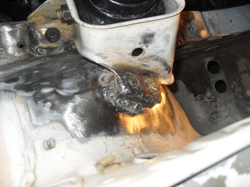

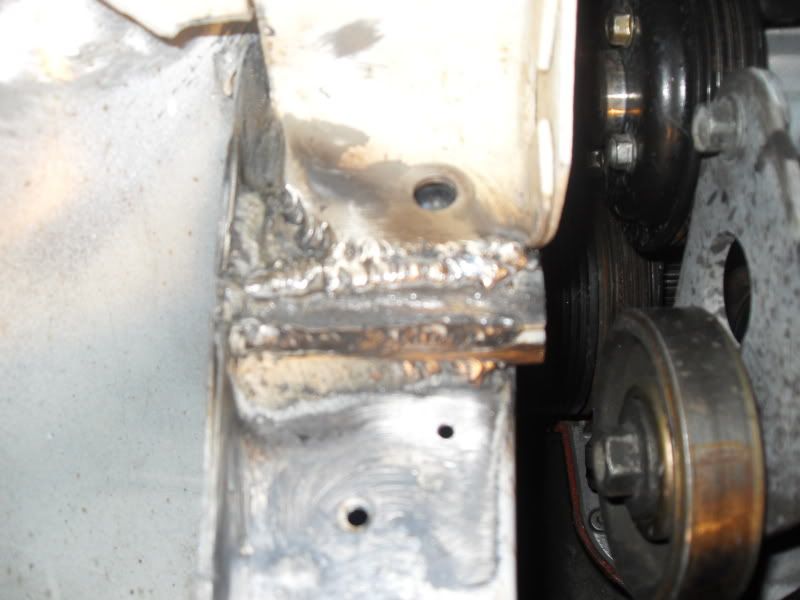

    what got done today:
    i got up early and went to the junkyard and picked up an mx-3 mount and bracket. got it home and mocked it up, it DID NOT fit at all. the motor was sitting way to high on that side to still be using stock bf crossmember, etc. none of the holes lined up and it changed the whole position of the motor. clearance issues everywhere.
    so i went back to the 626 mount and bracket. today i made it permanent with the help of my buddy's fabrication skills.
    dont mind my friend on the core support, he was keeping the car down on that side. lol
    half done.
    and done. bolted and welded.
    its not the prettiest, but im going for function right now, not form.
    after this, went ahead and tried out my mx-3 shift linkage. a little fabrication is going to be needed for the support bar, its a little too long on the trans end, but the shift bar seems to be fine. already put in my honda shifter as well. it made the gear feel even better with the longer throw under the car.
    and thats it for the day.

    NICE! to see.. i was hoping the mx3 would be able to rework.. to keep away from welding.. lol guess not. u find a harness and stuff?
    monoxidechild over on CP said he was heading to his junkyard this weekend. he said he would ship me a harness and fusebox..
    and yeah i at least gave the mx3 one a try but it was just too many problems.
    mike stood on the 626 one after we finished and jumped around on it. it seems to be pretty strong.
  12. #172

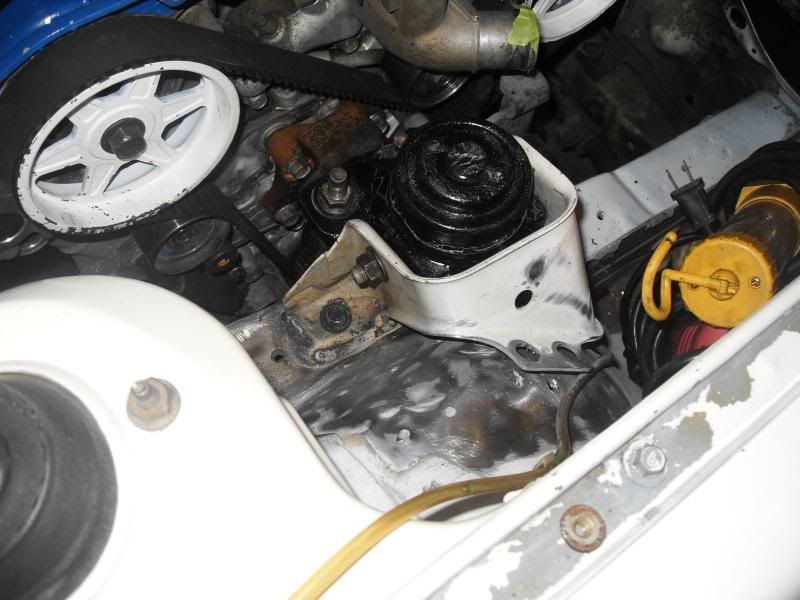

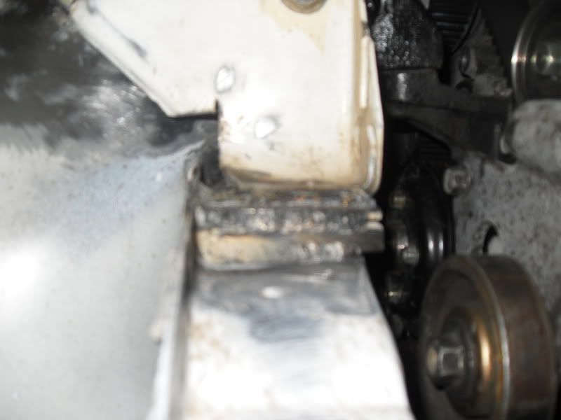

    pulled the car out again to clean up the garage. so i snapped a few pictures of the clearance under the car.
    oh also have plugs and wires in.
    looks pretty good.
    also modified the support bar for the linkage. had to take about an inch out of it to bolt up.
    also finished the front of the passenger side mount.
    and one with the hood in place. it does clear!

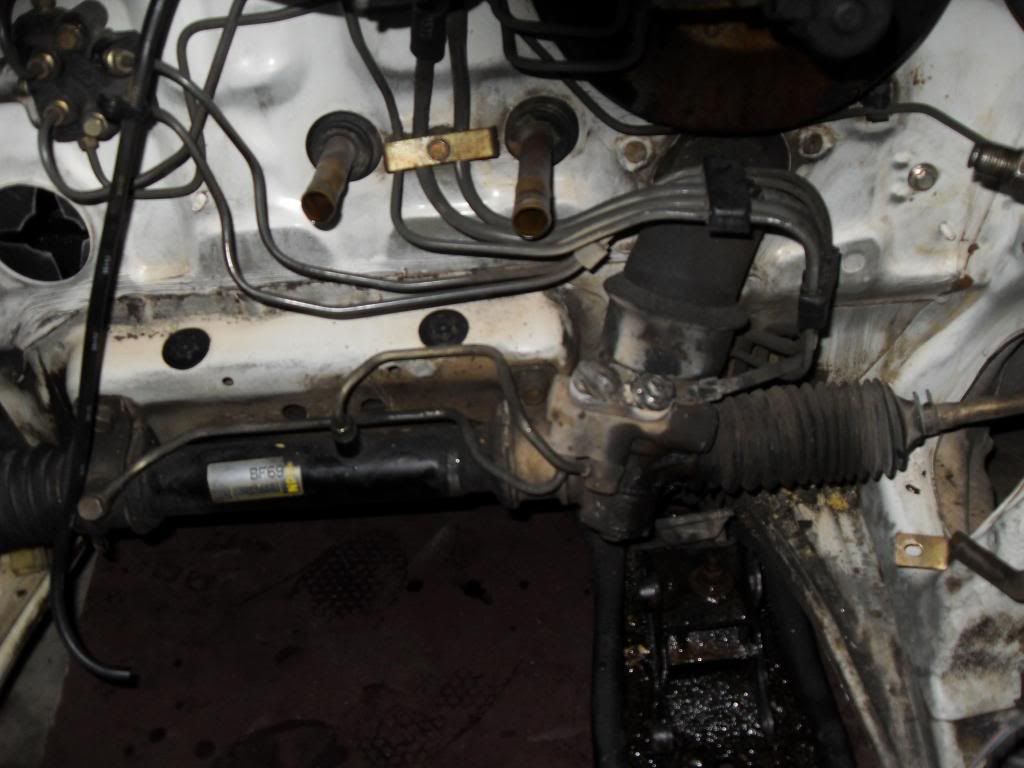

    did you connect the p/s hoses to the rack so you can loop it. dont forget about the power steering pump needing to be able to pump fluid so it wont seize up!
    loooks great tho!
  37. #197
    5,717
    no thats what i wanted to do but mike thought it would be smart to weld up the inlet and outlet. ill probably have to get a new one.
