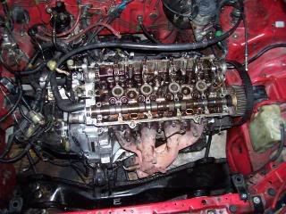

    Lol, it seems like its been forever since i last posted, but theres a reason for that. The reason is, because i had finally "finished" the car, i got it all up and running, i got it painted, emissions ready, and all of that. Since all that was taken care of, i had no reason to post. But, now there's a reason to post. This time, its all about the engine.
    The past few days, i found that my engine had piston rings that were so bad, that the engine would blow oil pan gaskets like you wouldnt even know. I replaced the gasket 4 times, and then, thinking that i was doing something wrong when installing it, got it professionally done a 5th time. Then, even with a professional install, it blew out AGAIN . This time, i was fed up with it and decided to drive for about a week or so, with the pan gasket leaking everywhere i go, and constantly filling the motor with oil. Well, it just so happens that one day, i forgot to fill the car with oil before i left school and i get on the highway and my oil lamp comes on and stays on. Well, i was at Sugarloaf parkway, and i was hoping to make it back to at least pleasant hill before stopping and filling the oil. BOY was i wrong . I began to feel the engine lock up, and i also began to see more smoke, and my water temp gauge was moving up as well. So, i stop, turn the engine off, and fill it with oil. Then, from here, i jump back onto the highway and within the space between pleasant hill and jimmy carter blvd, the engine was completely OUT of oil again. so i finally got home and the motor began knocking ever so slightly. stopped, parked, and replaced the oil pan gasket. re filled with oil and i also put some Lucas Oil Stabilizer in there too. But i noticed that there were some metal chips in the bottom of the pan that looked like they were made from copper or something...possibly my main bearings got chewed up slightly?
    I re-assemble it, hoping and praying that itll run and that i wont need a new motor (immediately anyways...). i cranked it back up, and it ran just fine.
    UNTIL!!!!!
    I'm coming on my way home from DiscoverMills mall, and i get on at Sugarloaf once again, and i drive to Jimmy Carter blvd. Next thing i know, the engine is overheating, and randomly wanting to idle like complete s***. It would drop the rpms to 200 then raise them to 800 then drop, raise, drop raise. Every time the rpms would drop, the engine oil lamp would come on... ...so im freaking out, trying to get it home so i could see what was wrong. I thought that i had cracked my block, but upon further inspection, there werent any cracks anywhere.... Also, in other places, there was nothing that i could see visibly, so i said this is the LAST STRAW. I sat the car up on jack stands and took the head off the motor.....and this is what i saw....
    Now, somehow there was coolant getting into my cylinders, becase on cold startups, a S***LOAD of white smoke would come pouring out the exhaust....and, when i took the head off, i noticed there was some coolant in each cylinder as well....then, upon further inspection of the cylinder head and of the intake manifold, i find that the coolant passage was COMPLETELY BLOCKED with GRIME . Now, the way i think this probably worked is.....
    1 - it had the passage blocked.
    2 - water pump kept pumping harder and harder, psi grew....
    3 - psi got to be too much that it just started seeping coolant into the cylinders....
    4 - when that happend, it separated the headgasket....causing the terrible idle.
    Thats just an educated guess though, lol

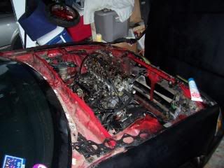

    BTW:: HERE'S AN UPDATE, I WAS WORKING ON THE ENGINE FOR THE PAST FEW HOURS SINCE I MADE THE LAST POST, HERE IS PICTAS:
    i cleaned and prepped the head...cleaned and prepped the block...cleared out that blocked coolant passage....installed new head gasket.....torqued the head down. here is where i am now, because like an idiot, i left ALL my rockers down at the engine shop, so it looks like ill just have to go pick them up tomorrow in order to continue with the build and get it all finished up
    btw...this is the installation of the stock head, not the modded one. The modded one is at the shop now being assembled.

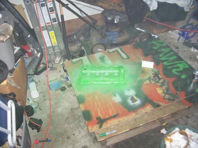

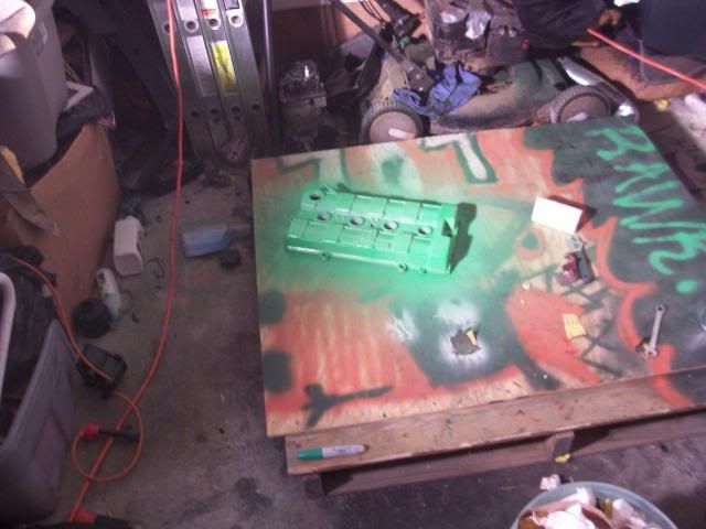

    Default UHM just a small one?
    Small update....ValveCover painted....and cams(yep painted too. )
    Its kindof weird, i think, how i did the valve cover this time because it seems to change colors slightly in the dark vs. in the light...Camera probably didnt capture that, but IRL thats what it does....
    1) in the light....
    2) in the dark...
    3)....stock-cams......:boobies:

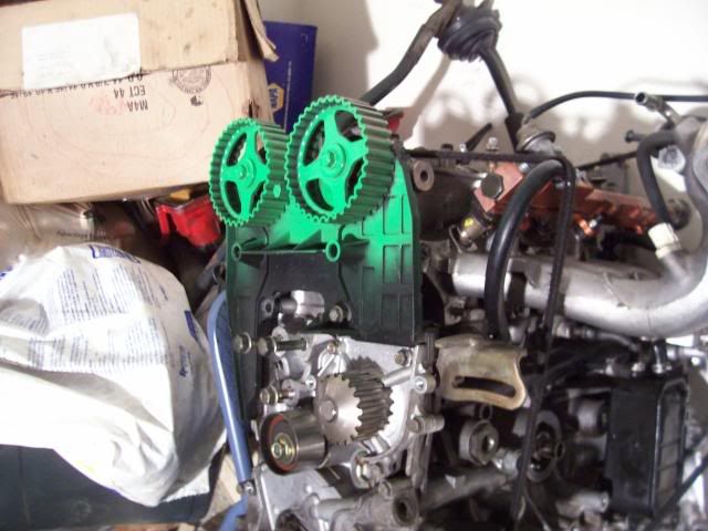

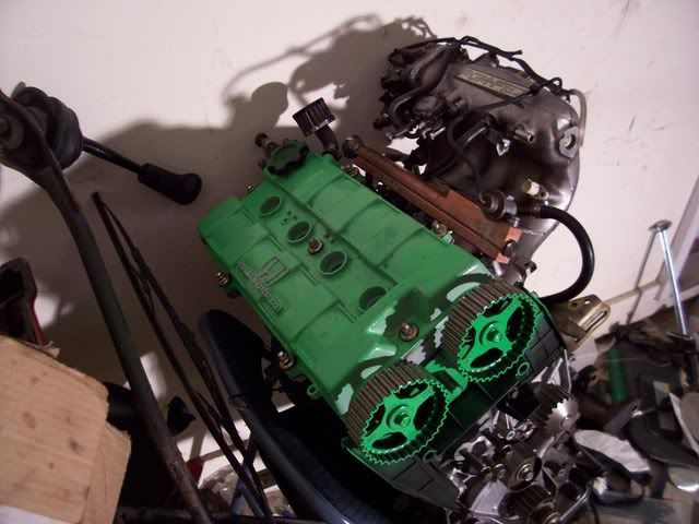

    Default and one final, before i hit the SACK
    Motor assembled w/VC and cams.....i hope thats not TOO much green..?
    hmmmm.....
    u remind me of a wigger !

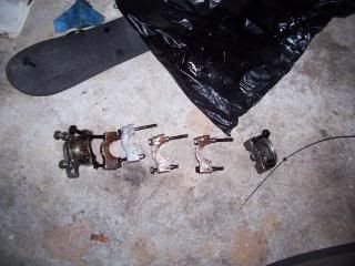

    OK, as some of you all know that the last thing that i did to the DA was i installed a GSR head onto the LS block, and converted the car to OBD1.... Well, i ended up spending a nice bit of money on it all, and didnt get a chance to upgrade the most crucial part of it, which was changing the LS oil pump to a P72 oil pump... which caused my engine to not like me anymore, and also caused it to send a rod through the block.. And before anyone jumps on me about it, i know i know i'm learning a VERY expensive lesson the hard way and if i build another one of these the oil pump will be the FIRST thing i change out.. Here's pics... R.I.P. b18b1.
    1)
    2) Carnage
    3)
    4)
    5)
    6)
    (Im just oh so HAPPY that it didnt get so serious in there that piston-to-valve contact was made)

    Default Yeaaa im a few MONTHS late on posting, who cares?
    Since that last motor blew, was the last time I updated this thread.. well, I'm gonna go ahead and update it again as of now due to the fact that I have a balancing out of the parts... First of all, I rebuilt another LSvtec after that one with the 100,000mile bottom end decided to spit a piston and rod out the side of it... Which was sortof a hard thing for me to finally decide on doing since my reasoning was, ''why would i build an 'almost' exact copy of the engine that i just recenly blew up within 5days of having it running..?'' and I almost sold all the VTEC parts in exchange for some turbo parts. Which probably would've been just as fun for me, running and building.
    But anyways, here we are.. I ripped out the motor/trans
    LOL i knew that hole was gonna be good for something...
    Then, shortly after that, I separated the engine from the transmission, and got to work tearing the rest of the block down just to see what the true condition of the rest of my equipment was before it blew..
    Windage tray...
    Everything else internally, looked somewhat good other than the fact that there was a hole in the block, and a crankshaft with one completely chewed out journal... Turns out, that the failure was due to this:
    Broken and Bent Rod bolts.... probably when the first one was starting to break, or had already broken was when the knocking started... and then next thing you, know, it all went flying.
    LOL only took me about a day or so to do that block ''autopsy'', and i was onto my next venture; rebuilding a new heart for the 4-doe, and cleaning up...

    Default Shaving, tucking, primering, etc.
    ^^^cont. from the last LATE post...Here's some sprucing up around the engine bay... I know, alot of you people don't like doing things with Bondo, but personally, I have no problem with it, as long as it looks GOOD in the end.
    chopped a coupla brackets...
    more bracket choppin'
    started spraying up the bay, did it in sections...
    next section covered....
    color testing lol
    HAD to clean it out! lol, my brake resivoir
    yech....
    cleeen cleeen tranny!
    mmm, i think i like this color best, ehh?
    mating call!! lolol
    Letting the whole assembly just sit in its *new* final home
