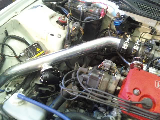

    ok well im posting up some pics. from installing the turbo. sorry it has taken so long to get them up and its not a lot of pics. i havent got up under the car yet to look at the situation i got because its been below 30 degrees with like 9 degree wind chill everyday. hopefully i will get to look at it tomorrow.

    the oil feed/drain set up isnt in the best spot, esp. with the feed resting on top of the mani. Pull off the pipes that clamps right on the turbo and see if there is oil in them.

    yeah your turbo should not be at an angle... you need to get a 45* an fitting to get that line off the manifold..... i bet its melted
    post a pic of the drain line.....
    i think that might be your issue..... the oil feed and drain

    so yall think that since the turbo is at an angle the oil isnt draining properly and oil is sitting in the turbo.

    you melted through the feed line inside the braided sleeve more than likely. angle isn't too bad as long as the drain is a good diameter and no low spots in it. if you can straighten it out more it won't hurt, but the angle isn't likely the issue.
