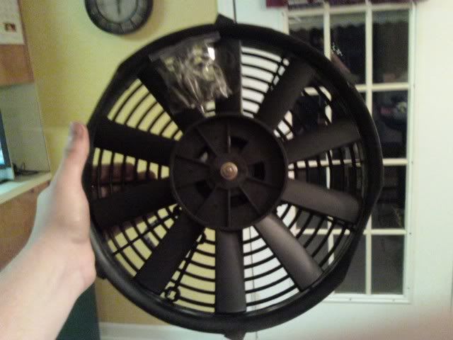

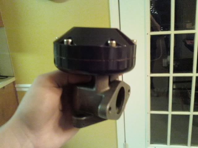

    got the rest of my stuff in today
    Godspeed 38mm wastegate
    Slim fan !

    Gospeed makes good performance parts. They have a manually adjustable wastegate too. I think its a 44mm. Keep up the good work.........
    500whp of spinnin fury!!!

    that wastegate placement is horrible. waste gate should be at the central area of the most pressure for all the runners combined. just a waste gate on one runner wont suffice.
    youll be fine your not building the star trek enterprise

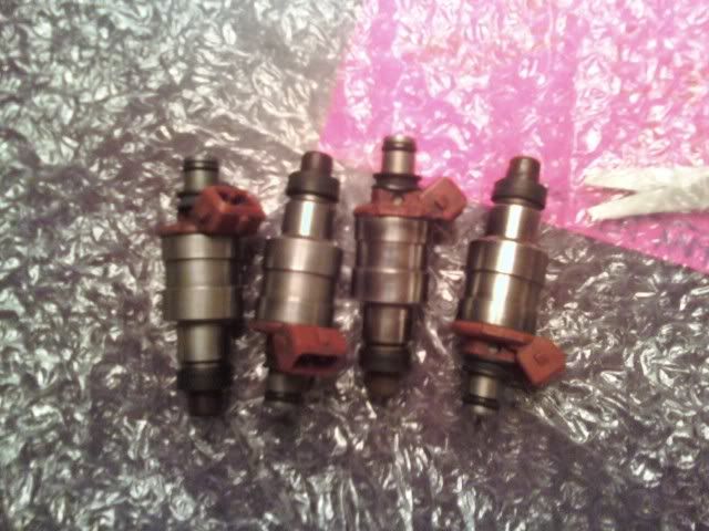

    the injectors came in also. the guy said they are 450cc but in says 530 on the side
    now im just waiting on the slim fan and the wastegate and ill be set [/quote]
    yea boost is going to be a nice upgrade... but on those injectors do u know wat they came out of bc they look like the rx7 injectors i use on my set up but they range in size they have 440, 450 ,530 ,and 550cc i think someone correct me if im wrong but u should find out and make sure b4 u get it etheir tuned or just getting a base map just my have fun with ur setup looking forward to the pics of wen its all done

    looks like hondas to me cuz of the rubber grommet on the titty...... but they have ev1 connectors and they will not plug into the obd2 harness..... you need to order pigtails.. ev1 pigtails on ebay..... 24 bux and prolly a resistor box as well
  22. #62
    ia "racist" dallasb84's Avatar
    Jul 2009
    1,767
    your base map needs to be configured for the injector type and size so it will run
    yea boost is going to be a nice upgrade... but on those injectors do u know wat they came out of bc they look like the rx7 injectors i use on my set up but they range in size they have 440, 450 ,530 ,and 550cc i think someone correct me if im wrong but u should find out and make sure b4 u get it etheir tuned or just getting a base map just my have fun with ur setup looking forward to the pics of wen its all done[/quote]
    im not sure what they came out of. the guy i got it from said it will fit hondas acuras eclipes. so i have no clue. LOL
