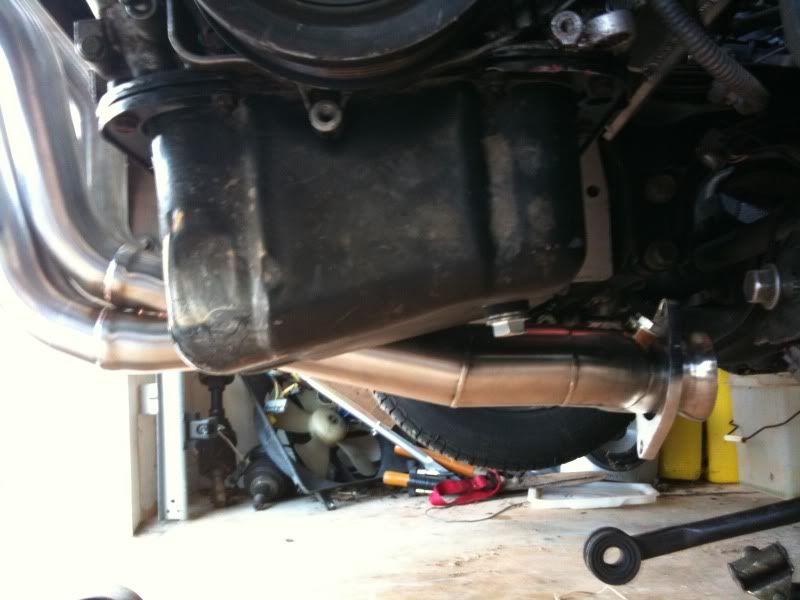

    Made an educated guess on where to cut the header and tac it up, and it fit rather nicely. Just barely rubs the oil pan at the collector now but everything else is spot on!!!

    kaizenspeed has a new oil pan coming out for H2B, maybe you make one yourself so i can get one too! haha
    i haven't gotten my header modified yet, but managed to rig it up

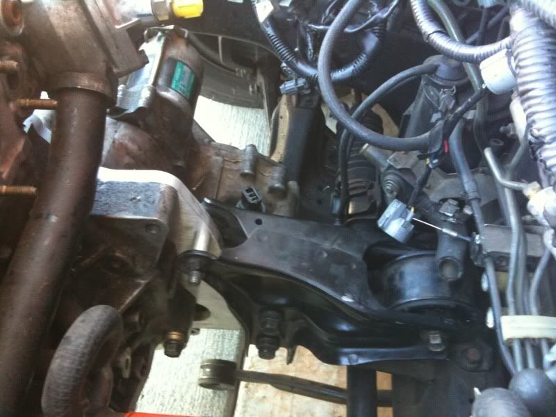

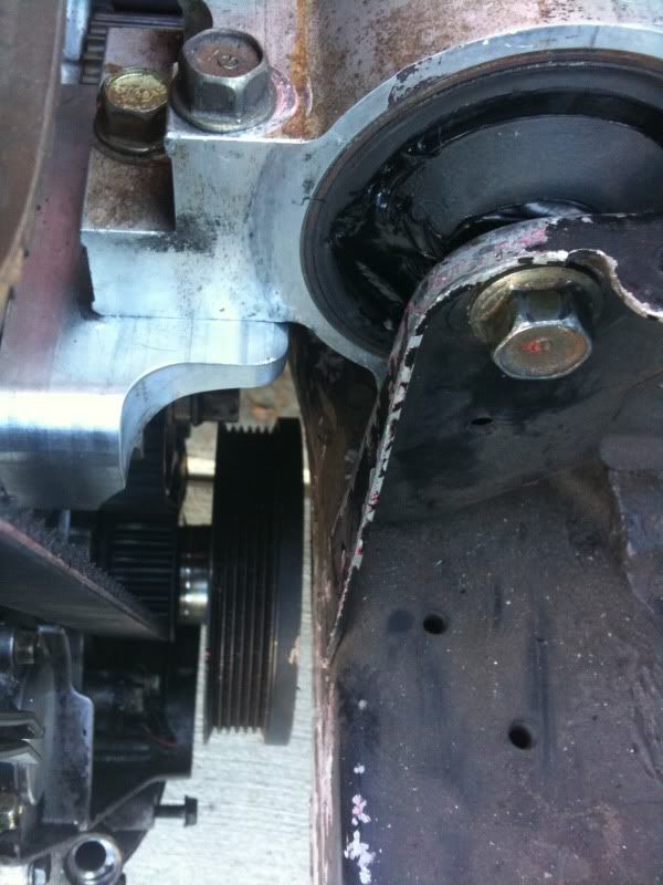

    Final mock up

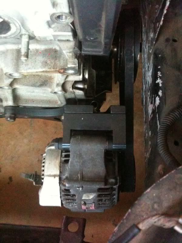

    Look at all that clearance=Put your alt belt on before putting the engine in the car
    Rear mount
    Pan clearance, the suspension is still the same as it was for the 15's plus the tyres are really low on air. I will raise the car up about a 1-2 inches.

    haha. are your moving the crank pulley in 1/2" or not?
  24. #104
    347
    Its in as far as it will go right now. I can still cut some off of it but there is plenty of clearance now...well enough lol. If I cut all that off and move it over then I have to do the same for the altenator cuz they line up pretty good right now. Looking at that first pic made me realize I need a throttle cable bracket
  25. #105
    2,451
    are you running the alternator in the stock position? i have the lower alternator and moved in crank pulley.
    tilt the alternator belt and slide it on
  26. #106
    347
    Im running the Evo alt kit with a B series alt. I tried, not quite enough room.

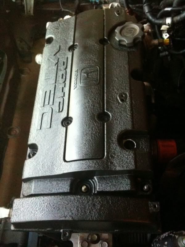

    Made some hood spacers today, should be able to paint the VC tomorrow, and hopefully get some fluids in it this weekend. Although I do have to help tune a turbo dodge on Sunday and take my son home...never enough time

    Got everything sorted out Saturday...lots of grinding on the block and oil pan to get the half shaft in. Tons more grinding on the Alt to make it fit (using a B series Alt). The hood closes with 1" spacers, no grinding on the hood to make it close. Just ordered my IAT, MTF, and TB gasket from Honda. Tried to order a throttle cable bracket but its on back order indefinately. Guess I'll have to make one.

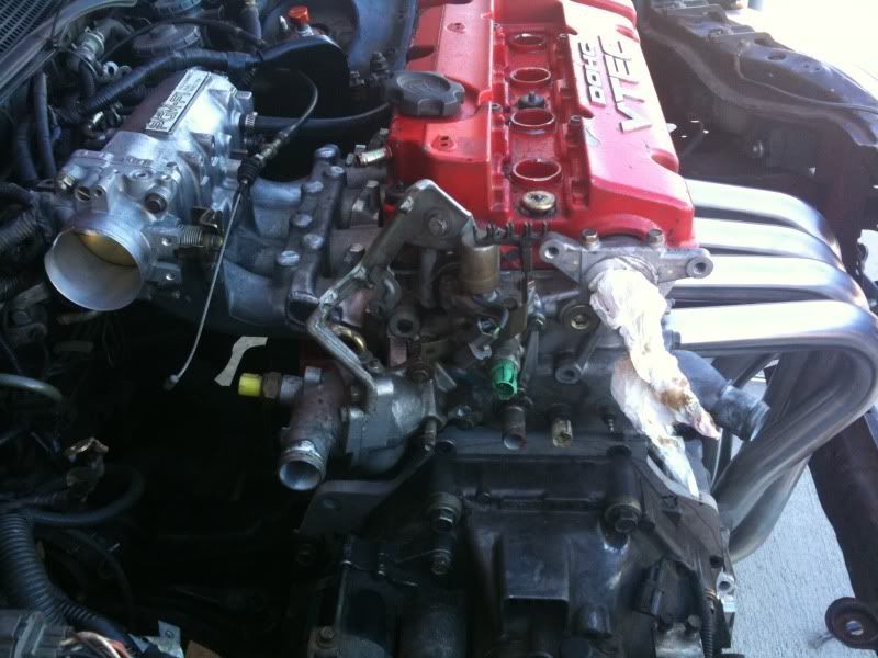

    Anybody got a stock EH2 throttle cable? IDK what mine is but is way to long. Made a bracket based on the H22 one but as you can see from those pics, the end of my cable is about 4-5 inches from where the bracket needs to be. I would have to make a bracket that attached to the opposite side of the manifold...its always something
