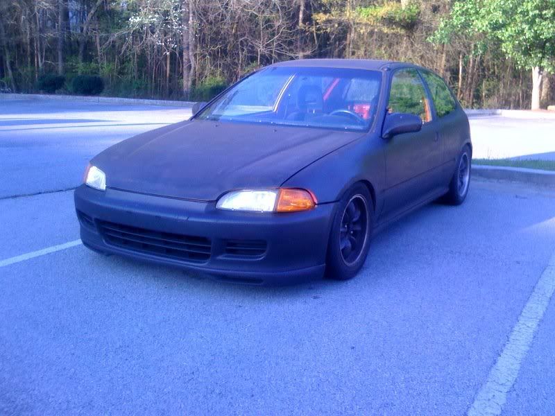

    The hatch:gutted, ugly, and beat up. Ive had this thing for ~9 years. Used to be red with a B18C1 - 150 shot when I first built it 9 years ago. This will be the cars 6th hart transplant. (2 B18C1's, D15Z1, D16Z6, B18B) This is its good side

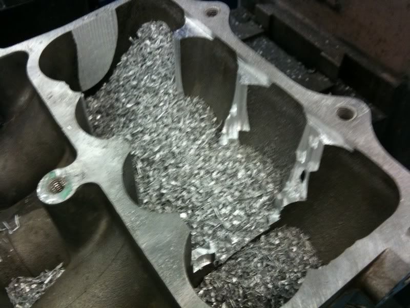

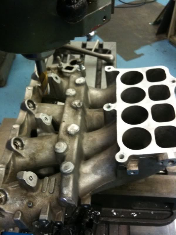

    Modding the intake manifold: Start

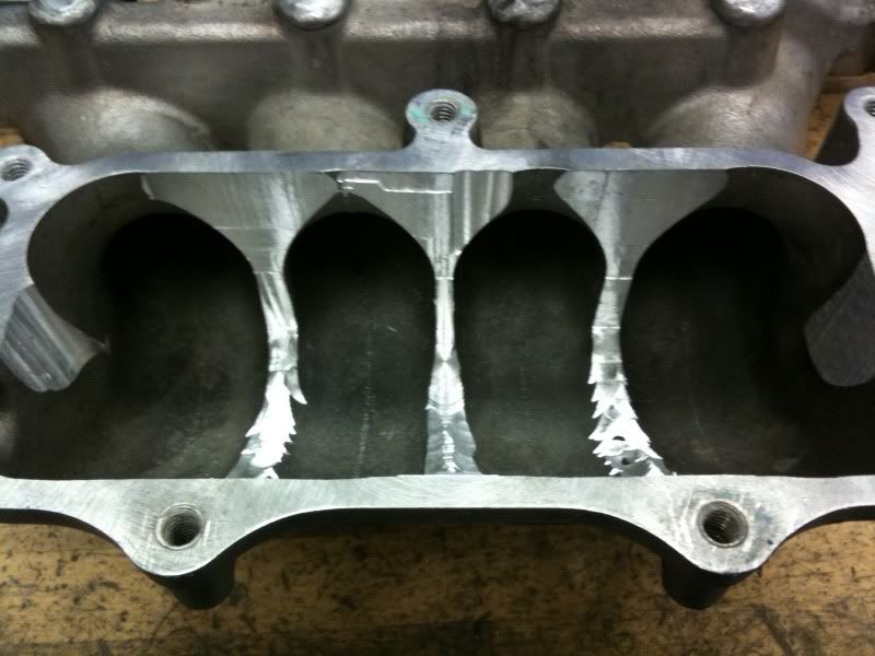

    Webbing cut away:

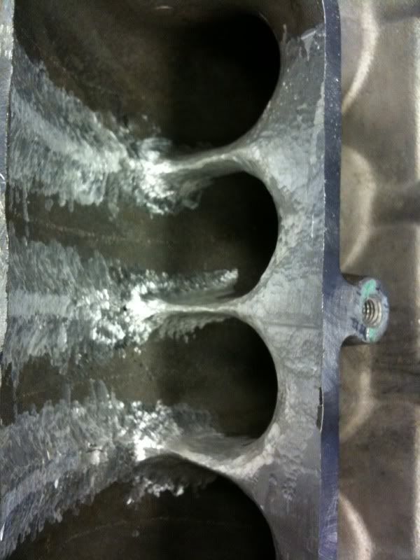

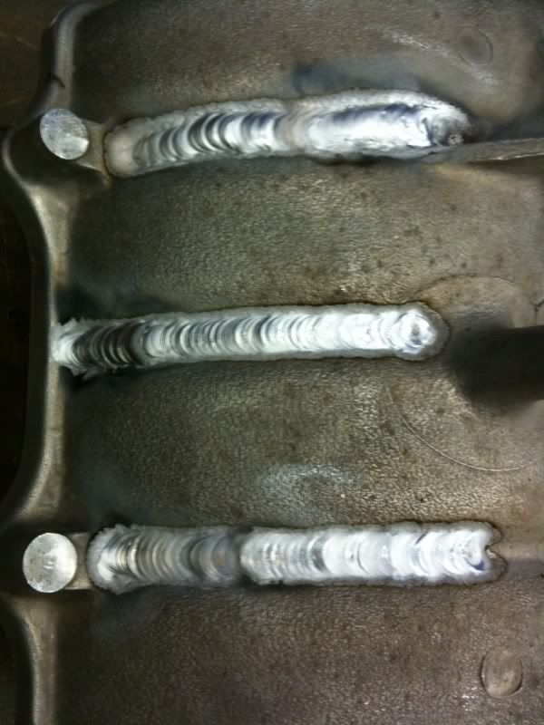

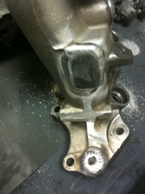

    Welded up the back to port it:

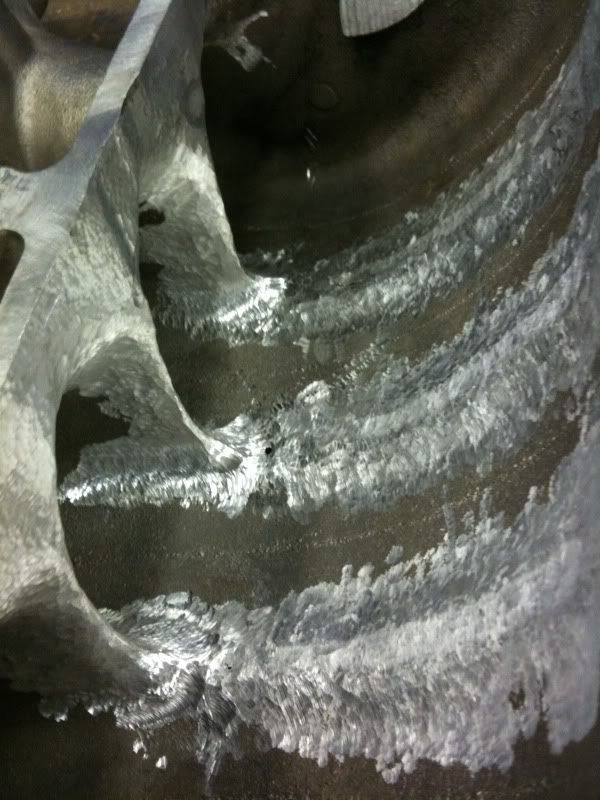

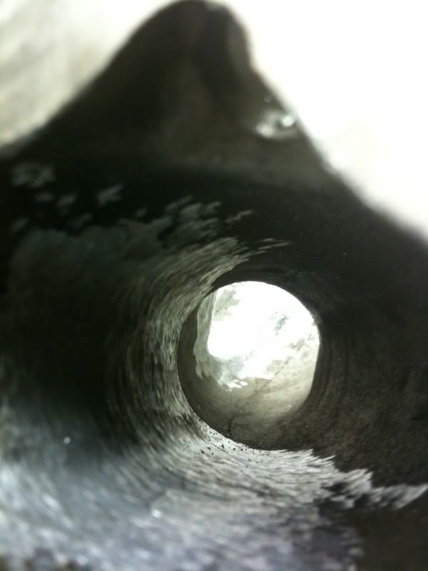

    Mostly ported:

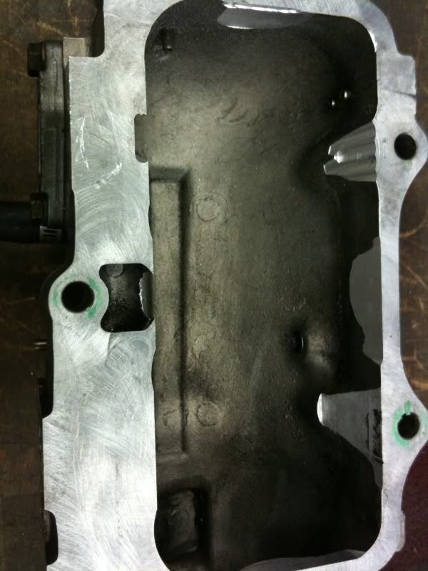

    Cut off the EGR crap and plugged:

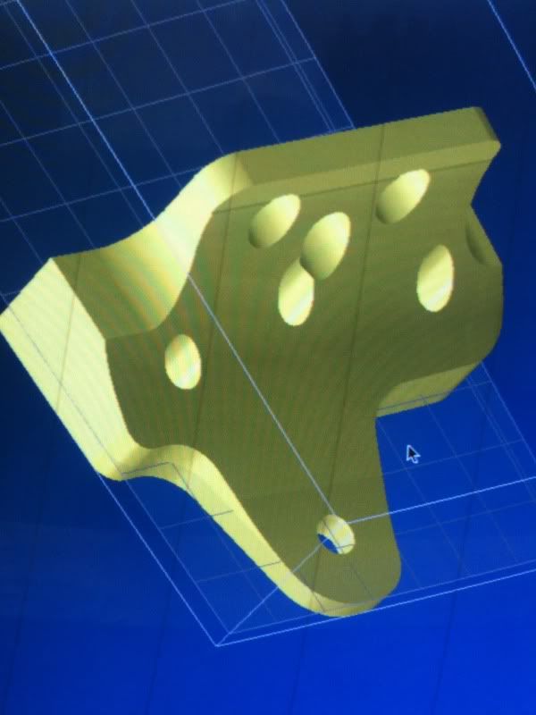

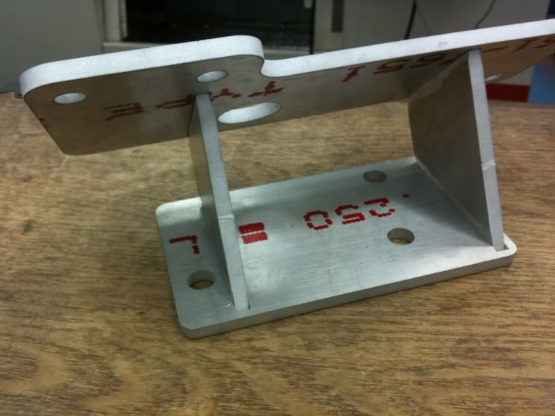

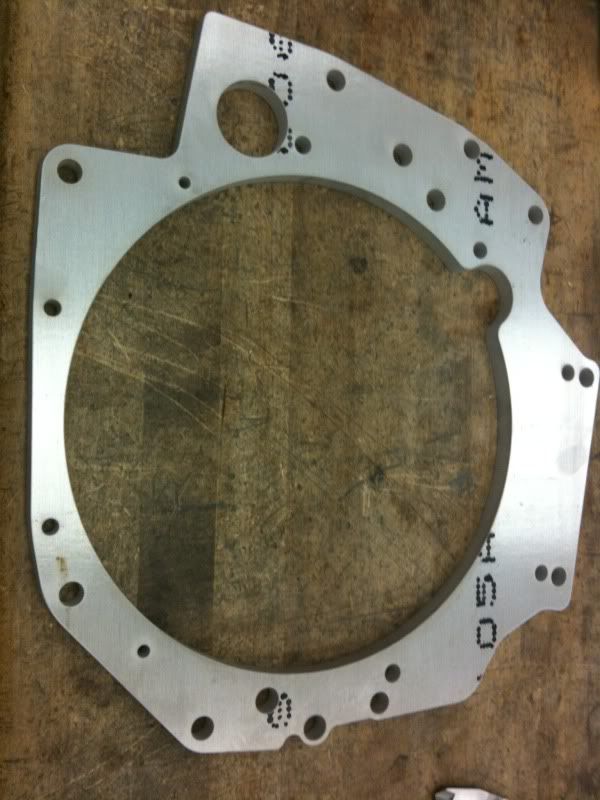

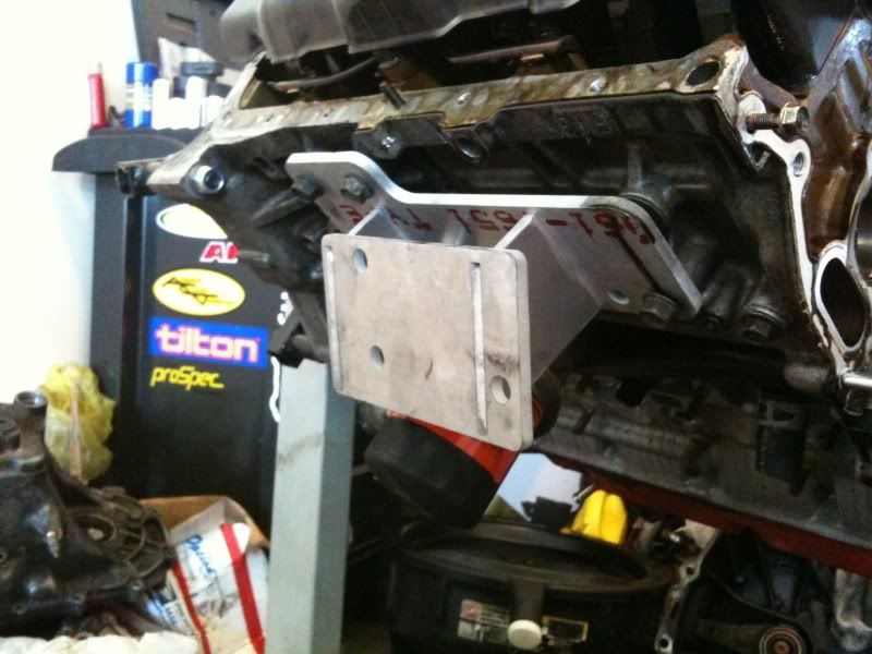

    Motor/tranny plate:

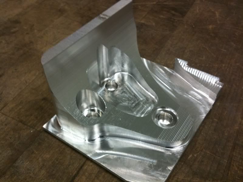

    Halfshaft plate:

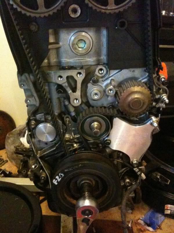

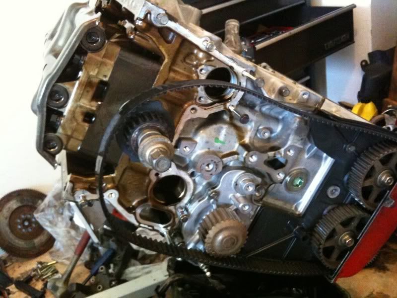

    Dissasembled the engine for BSE kit this weekend:

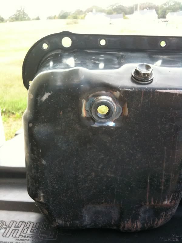

    Tonight I'll be pressing in the plugs on the oil pump and girdle. Should be able to get the motor ready to bolt in by this weekend. I work about 50hours a week and drive 45 minutes to work (one way) so weekday stuff is sometimes tough to do.
