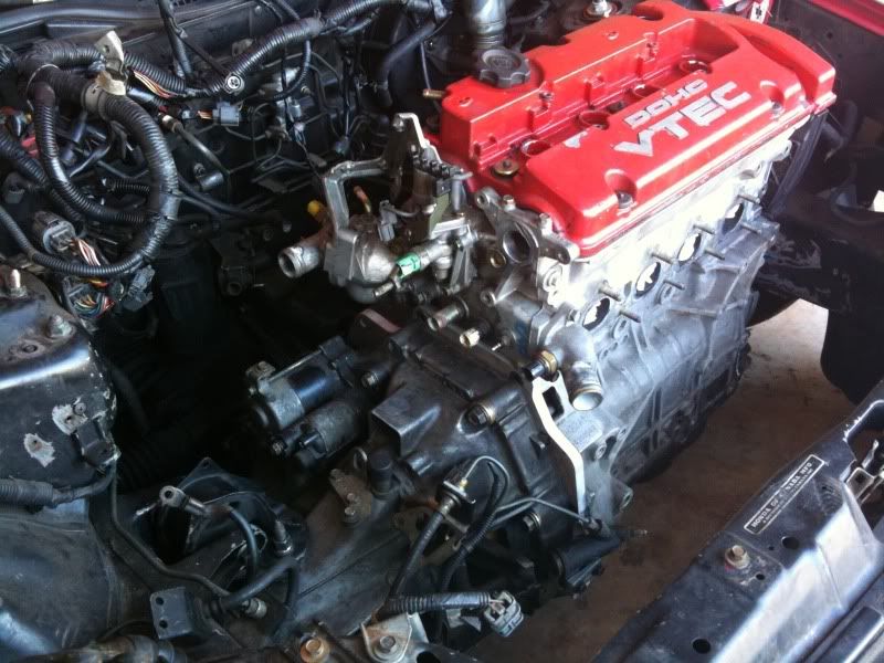

    Finally got some help pulling the engine off the stand so I can finish this beast.

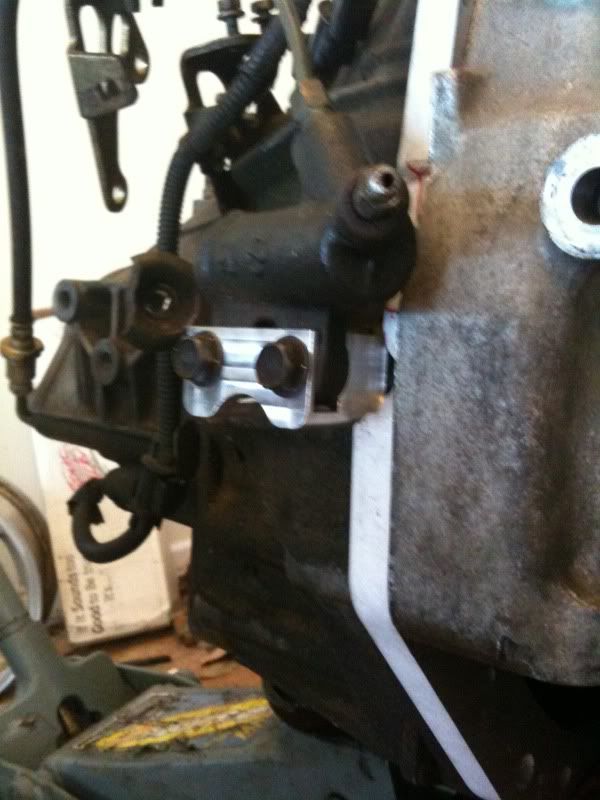

    Motor/tranny plate:
    Halfshaft plate:
    Factory Perfect FreeMyndz's Avatar
    Galt's Gulch
    114
    is that "dent" with a rattle can job?!?!?
    looking good man...been a LONG time...
    347
    Of course its the dent with a rattle can main. Im doin it up FP style.
    If anyone just wanted the plate and half shaft adapter, I'd be more than willing to do that. If thats all you want then no problem, we can has tons o H2B's in the Atl.

    So I ordered flywheel bolts from QSD last Tuesday, they showed up on Friday. Those guys rock!! Gonna bolt up that crap tonight
    347
    Its in!!!! But its coming back out cuz some idiot put the spacer on the wrong side of the pulley I meant to swap it around before putting it in the car but forgot about it untill I tried bolting up the driver side mount. Back out she'll come, going to move the oil drain, window weld the mounts, and tonight I'll test fit my header since I left it at work this weekend.
    Suprised by the amount of hood clearance. Wont take much to make it close
    Pulley against frame

    Yes they are!!! Do you know which starter is the proper one? I have an Ls and one from a B18C5. I think the one with the teeth slightly covered up is the correct one but the pic on H-T is no longer there. I could search but figured I'd ask you first. My pre-production header doesnt fit at all so Im flying blind a bit on the mods to it today. Hopefully I'll be tuning this thing by the end of the month.
    2,451
    Quote Originally Posted by Jenson View Post
    the one with a short stout nose
