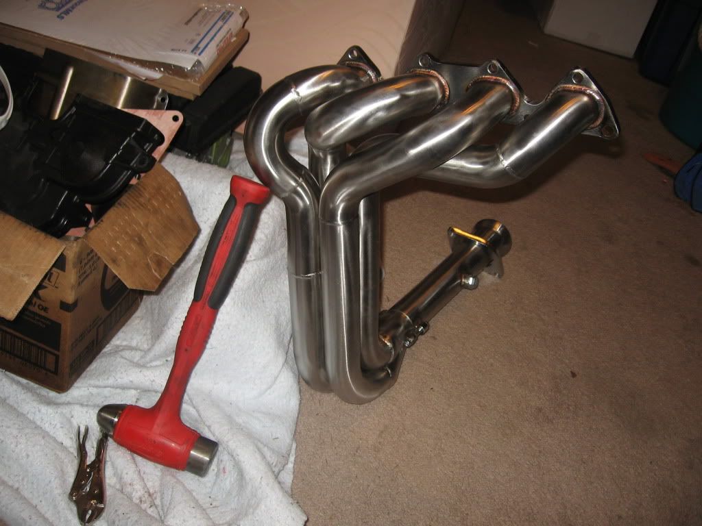

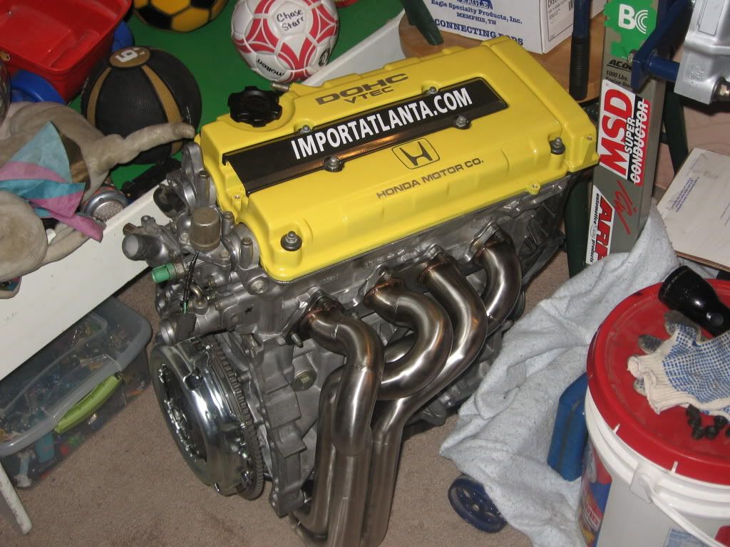

Alright, I finally got my header today. Took a while but you can't beat it for free. Gonna put it in Friday and get it tuned Saturday morning. Wish me luck
Just wanted to post up some pics of what it looks like mocked up.
OOh pretty lol.

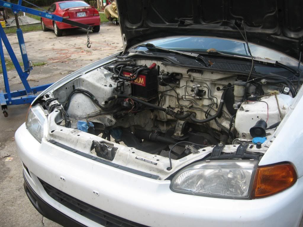

Well current progress is that I got home and took the engine out, took about 3 hours to have the axles out and the engine sitting where it needs to be with the intake manifold off and on the other engine. Just gotta get the rest of the shit on the other one tomorrow and get it in.
gotta pick up my new reman axles since the boots are starting to F up on the current ones. So close with so little left to do. No turning back now...I hope.

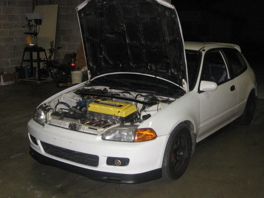

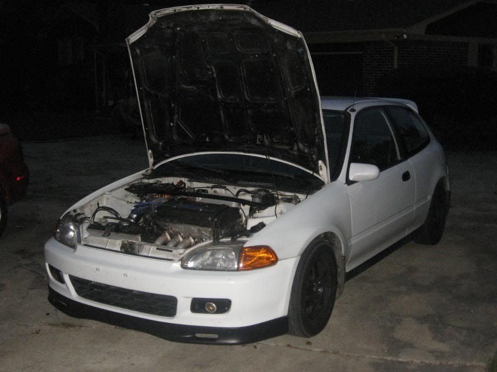

Well I got it in, and I must say, I ran into a whole shit ton of problems.
Just seemed that everything was running against me, first off getting it in there was no problem. But later I noticed that that the 40/40 prop valve my friend put on was cross threaded on 2 of 6 of the fittings. Well with the engine in, it is really hard to change these anyways. So I tried putting the stock one back on to no effect, the lines themselves. I thankfully managed to get the one for the passenger rear threaded back in. Thankfully. But the driver front wouldn't do so, it was to F'd up.So I took it off my other hatch and put it in. So basically I spent 2 hours of my time fixing complete bull shit. It crunk up flawlessly and ran great considering it was un tuned. I drove it 50 miles and changed the oil.

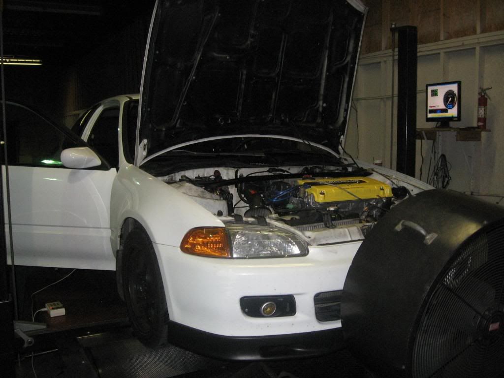

Next morning I went down the road and about 2 miles away from my house my driver side axle popped out from the half shaft. I got my friend to bring me some tools and I used my slide sledge to put it back in. Then I drove the 1.5 hours to get it tuned. I got there on time still, but the dyno operator was late, and my tuner was late also.
So I got shafted somehow since the people who had later appointments got to go ahead of me, and my friend had to be home earlier, so I had to drive back home and go back down there and be there at 6:30. Not to mentioned I hadn't slept in about 36 hours.

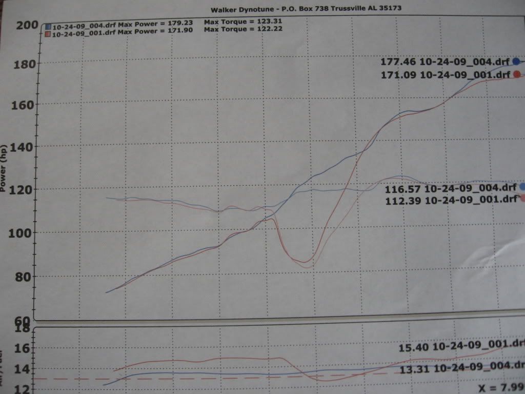

so it mad about what I expected it to. I was thinking truthfully at 185/125, but it made a little less. It sure does sound good. I had only actuated vtec once during driving it, and it bogged like a bastard. The cam opened up too early for my current map which with such large secondaries slowed air velocity. here are some pics at the dyno. The car is dirty because I haven't washed it due to all the rain.
Awesome! Sucks to hear about the problems you had with it! Where did you take it to get tuned? That's poor service if you ask me.
179/123
Well here's the tune sheet. look at the mega dip on vtec engagement to start with. As you can see I picked up like 40+ wheel in the mid range. It is still a conservative tune on a known low reading dyno(just a little so) It's still 21 wheel over the other gsr and
oh and it was Walker dyno.
