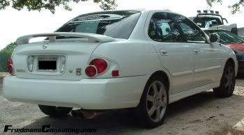

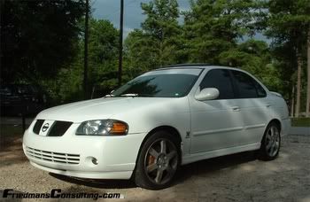

    I think these are the last of the construction pictures:
    It's running great, the idle is a little low, and I need to recirculate the wastegate and add a flex section to the downpipe, but it's well worth the $1052.00 it cost me to do it. I'm really ready to upgrade the injectors, get a boost controller, and turn the boost up. But all in time, I've been patient so far.

    Public Enemy #1
    11,300
    you now though you have at least pushed it hard one time already....does it blow the tires off in 1st and 2nd??????

    JDM swaped shortbus Big J's Avatar
    1,110
    1st and most of 2nd if I shift hard. It's only on a 3.6 PSI WG spring.
