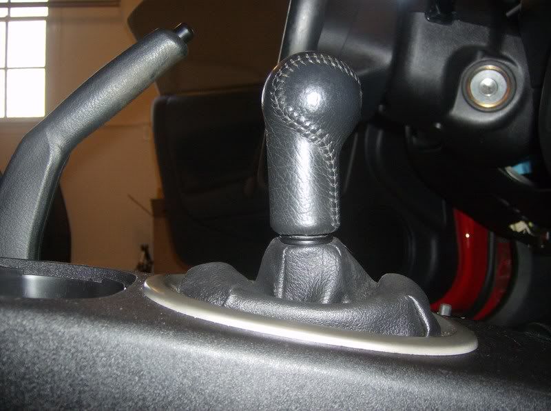

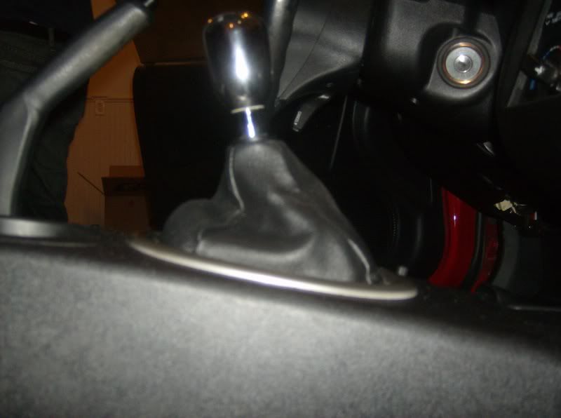

    I just installed my short throw and correct me if I'm wrong but I thought they were supposed to sit lower than stock. Mine actually sits higher. The throws are shorter but it just doesnt seem right. IDK. Here's the pics.
    Stock.

    The way the knobs are threaded might cause the slight visual difference.

    i hear ya just seems like the B&M actually sits lower in addition to throwing shorter

    no it sits higher look at the boot its streched to the limit gotta see if i can let some slack out of it

    I meant how deep the shift knob is threaded. Most likely the threads sit far back in the stock shift knob, while the aftermarket is threaded closer to the bottom of the knob. When I switched my knob to an aftermarket one, it sat one inch lower. Try putting your stock knob on the short shifter.

    i dont think you understand what im sayin THE SHIFTER THE WHOLE THING IS HIGHER. I compared the two before instalation side by side and the new one is actually longer. IDK i guess i just wasn't expecting it to sit this high.

    I just put a Kartboy in my car. The height is almost equal to stock, maybe even a little taller, as the boot stretches a but more than normal when shifting, but the throws are definitely shorter, so as long as that's the case don't worry about it.

    It's important to note that a short shifter isn't actually shorter lever necessarily, it's just a change in the geometry of the linkage and the shift lever. It rases the coupling to the linkage up a little bit, so it doesn't really matter how short the lever is.

    I realize that like I said I was just worried I installed it wrong or something. But i talked to someone on the eclipse forums seems like everything is ok. I gotta see if I ca nlet some slack out of the boot though cause it's so tall you almost have to force it back cause the boot is so tight
    the Greddy Trust shift knobss are pretty much fully threaded through,so itl lower the apperance a little.friend has one on his 98 civic hatch and the shift boot like sinks in its so short looking. that might help if you have an extra 80$or w.e left for a damn shift knob.

    For the record my short throw is about an inch lower then stock height wise, but shifters can very, theres a few for each car and all have different aspects about them, i wouldnt worry about the height if everything seems fine, maybe get a new handle?

    We had this discussion on another site that I'm on a while back ago. But in a nutshell, When you are trying to go for a short throw shifter, the point below the pivot point has to be longer. If you shorten the top half of the pivot point you increase the effort needed to move the shifter in the same in the same manner. But a properly designed shifter usually has those aspects in mind. I built my own shifter and I purposely made the top half longer and put the shifter closer to my driving position. I also increased the lower portion of my shifter by 1/2 inch to shorten the throws. It looks stock and yet works way better. I wouldn't worry about the shifter being taller. It's probably working out better your your good
