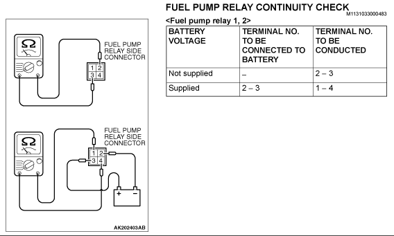

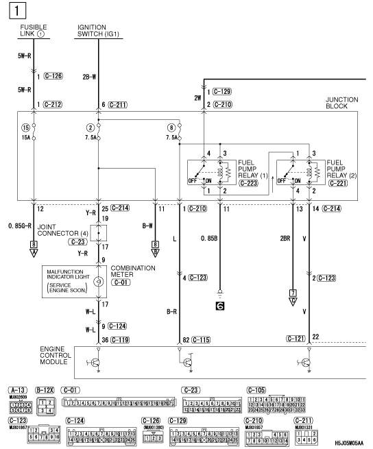

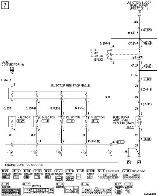

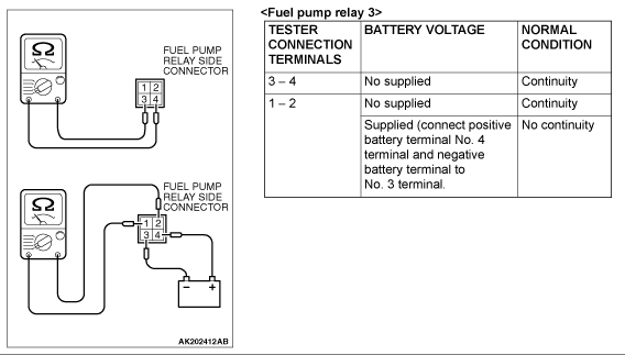

I'm trying the cheapest/simplest parts first before I start looking at the 12v wire running to the fuel pump directly or worse the main harness. So through some of the threads here I found other people with the same issue and some of the suggestions thrown out......Beyond it being a wiring issue (nightmare), or a crank angle position sensor (2 different motors and the same issue would lead me to believe this isn't the issue) the simplest thing to check is the Fuel relay.
Any other suggestions? I posted this in turbo forum but I think I might get a better response here (esp since I have a more direct description of the issue.
I tried to order from the dealer but its a special order part and will take a while to get here....mitsubishiparts.net shows 4-10 day turnaround ('ll call them to confirm) and I've hit a few part out people up. No responses yet. Hoping someone has one lying around they don't need that they can sell me or just send me. I'd like to get my car running asap.
