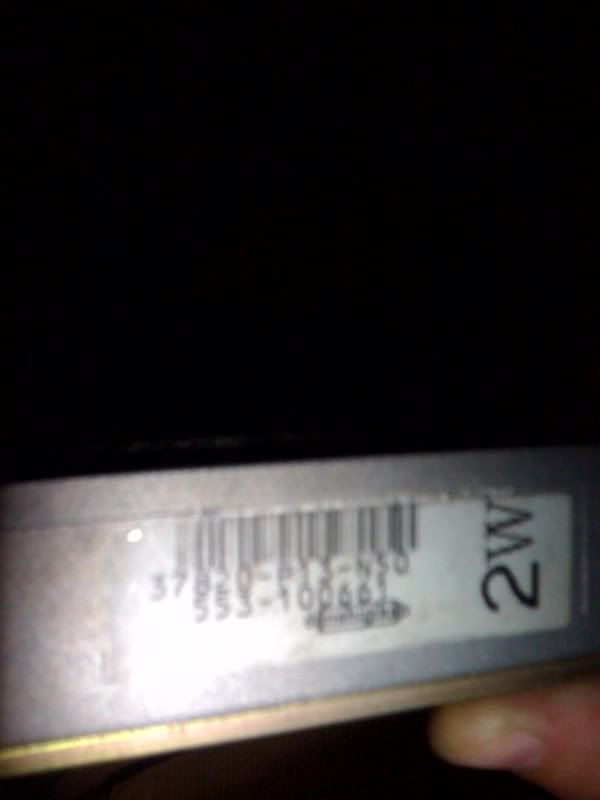

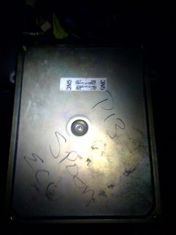

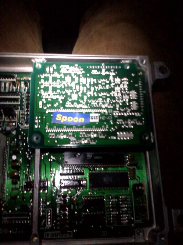

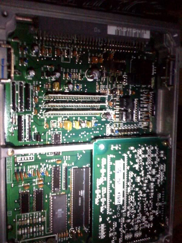

    my ecu is the only part of my car i didnt get my self and i was told i had a p13 spoon ecu, well i know it is a p13 but i dunno about spoon. heres pics whe ni opened it up, only thing i know is have no speed limiter. and vtec maybe early
    so i opened her up.. check on the pics and tell me what you think, i didnt see anything spoon, that blue spoon thing was just a piece of paper floating around in there.
    thats what was written on there i guess
    model number i guess

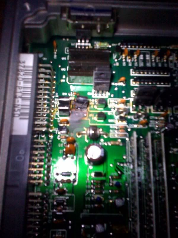

    in the top left of the picture there is a component that has been burnt,blown,shorted etc,w/e, it looks damaged and probably not working, anyone know what exactly that part is/does?

    automatic h22a ecu. i know for the civic/integra ecu's something like that messes up too. i was working on a car, that burned up 2 ecu's, something in the engine harness was bad, probably a bunch of bad wiring. it looked rigged up. so i put in a known good working harness. and problem solved. i heard if you have plugs crossed up, it can do that too?

    i know automatic ecu's will work on manual cars. some throw codes, and some don't i guess. but yeah, i think you should get a new p13. all of the ecu's i've dealt w/ that had a burned spot, couldn't be fixed, cause the track[s] were burnt up.

    That shit is burnt lol wtf. I bet it doesn't idle good.

    Oh btw that burnt spot happens a lot when you mix up plugs on the wiring harness

    more than likely you have the iacv/iat/iab/pwr steering plugged up wrong and it's fried the ecu.
    we need to double check the continuity of the wiring before you plug in a new ecu to make sure you don't fry another one.
    if you get the ecu the same day i tune you i'll check to make sure you have the iacv/iat connected properly before we tune/plug in the p28.

    and the p13 isn't a spoon as are the majority of the ecu's out there that say mugen/spoon/etc. they are just hacks that put a decal on it and sell it for more than it's worth. all they did on that p13 was just adjust the binary/hex code to remove speed limiter and maybe shift vtec...possibly increase the overall timing and fuel trim, but it's far from tuned.
    the only way to really get a tuned ecu is to have it tuned in your own car on a dyno.
