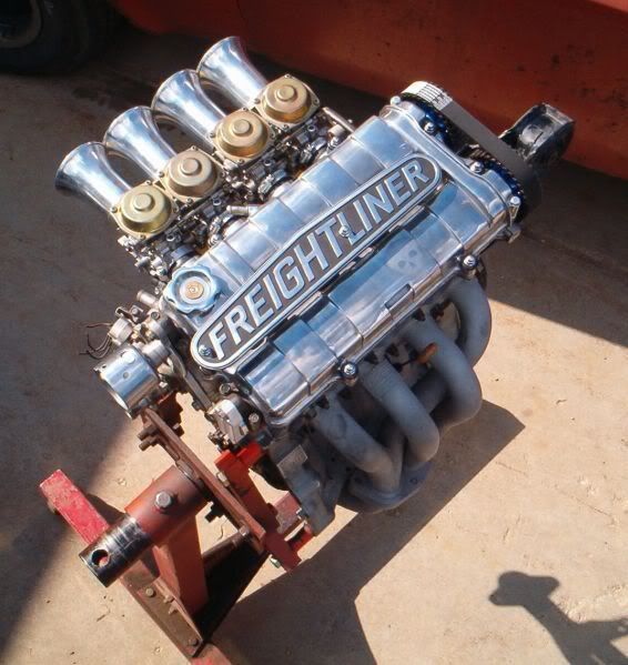

    I'm bored so I decided to clean up my picture files and found ze B18C,
