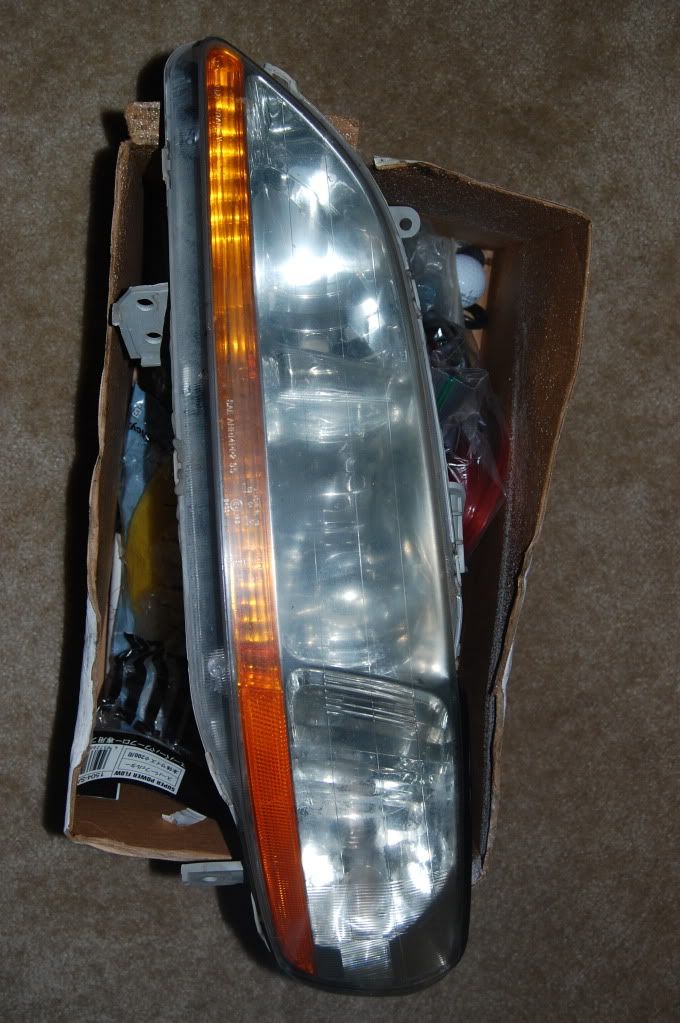

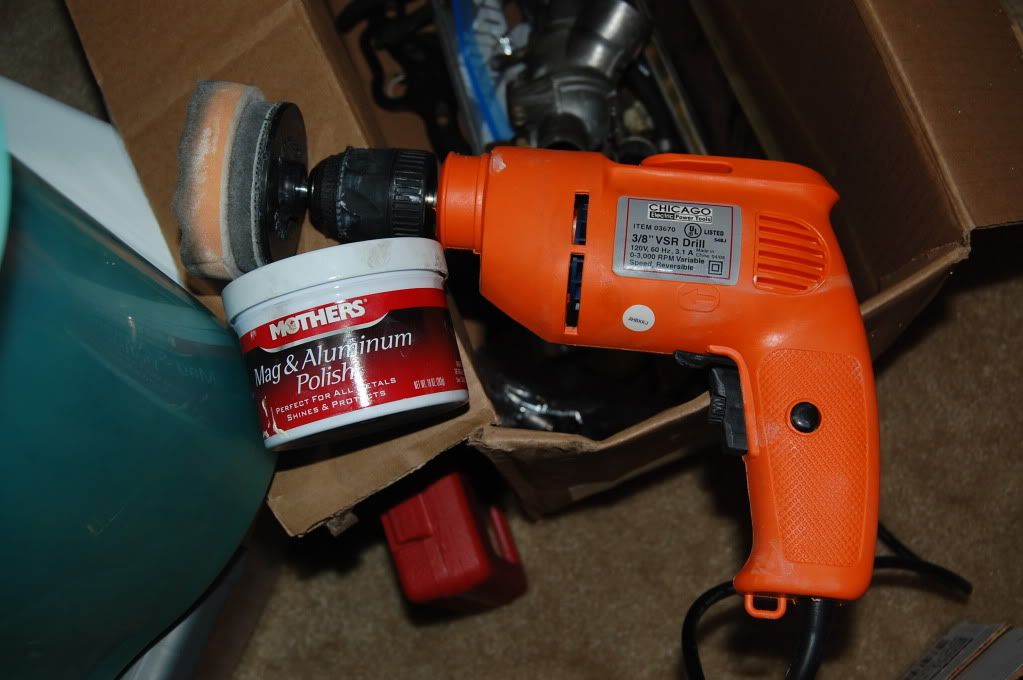

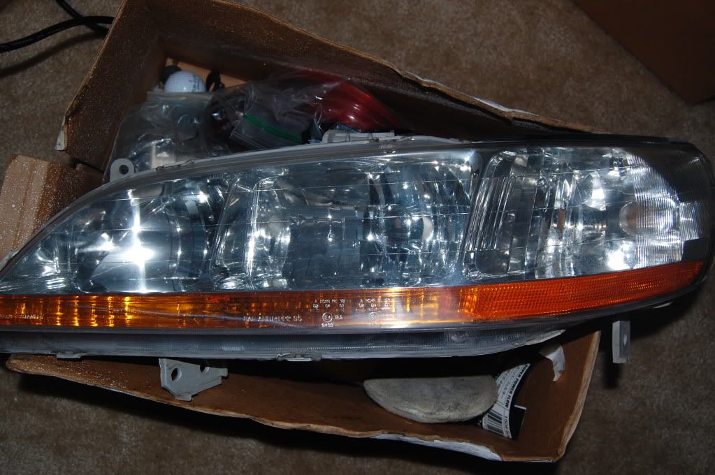

    I don't know if this stuff will last or if it will eat up the headlights. But these are spare headlights I had laying around. I made a mess the first time. I recommend wiping the polish on with a pad and then using some powered polishing. Don't recommend applying polish to the power tool, apply to headlight instead. DOh!!

    Seriously, metal polish is the best for plastic polishing. I've been doing it for years. Blue Coral makes a metal polish that has a silicone sealant in it too and have found it works the best.
    I think the Mother's M&A Polish was like under $10 for the 10oz and under $5 for the smaller size. I'll have to try the Blue Coral. Even though the Mothers did a decent job it wasn't perfect. Maybe I'll go back and do it again and longer polishing time. It's plastic so I didn't want to over do it.

    No I didn't wet sand it, just wanted to spend a minute on it and see how it would clean up without any effort. Lazy.... yes very!
    If they weren't my spare headlights that I don't plan on using, then I may take the time to wet-sand it.
    I don't even know where that foam polishing pad came from, it was just in my toolbox. It may have been from the 3M kit.
