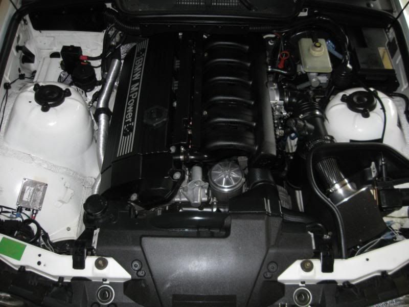

    Finally got all the parts for the OBD1 conversion and swap! Amazing what a little degreaser and a scotch pad can do...good way to spend valentines day lol! :boobies:

    sorry to ask the nOOb question but what motor is that?? very very clean!!

    2.8L BMW m52 I believe.
    Looks great btw. I've ridden in a semi-gutted s52 e30 before and it was unreal. I can't imagine a turbo 24v

    Quote Originally Posted by jcbe34
    Bingo. With head gasket and studs the M52 will hold up to 25psi. Should be fun!

    I'm still debating, this is a single VANOS engine and it's on the fence about MS working with it or not. I'm looking at the eMS-Pro but TRM's chipped ECU is basically plug and play for a little less and includes tuning. Right now I'm just going to run a Bosch 413 DME until I put the turbo on.
    I think you're talking about Donovon Marvin aka BMWSOB. He's one of the few online that have videos of an M52 turbo in an e30. The M52 has a lot more meat between the cylinders so it's far stronger and safer for boost. M50/M52 & S50/S52 are all the same block casting anyways, the motorsport engines are just a bored out version.
