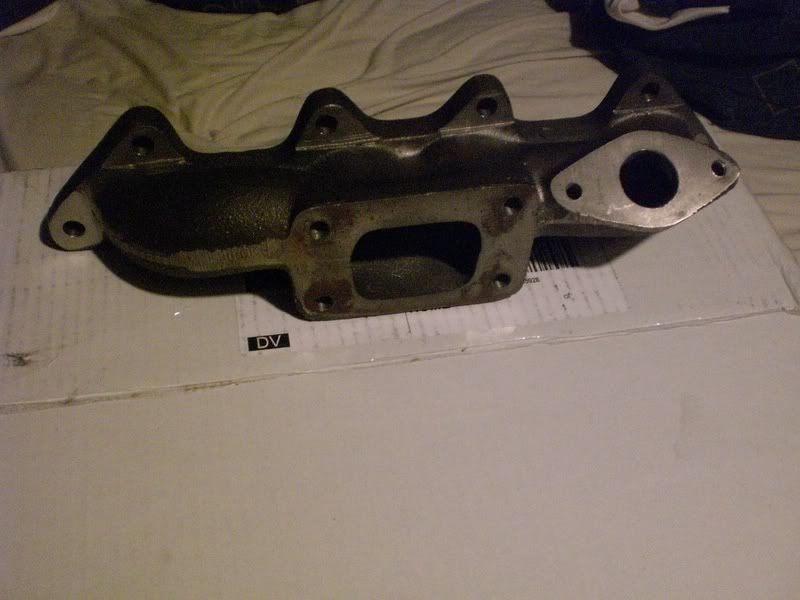

    • Treadstone Turbo Manifold

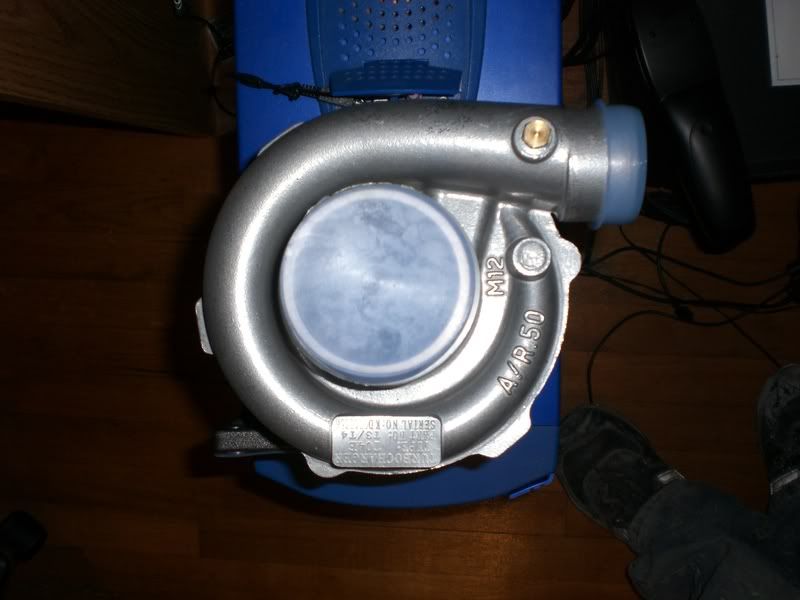

    • XS power turbo T04E .50A/R compressor, .63AR turbine

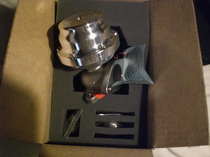

    • TiAl wastegate .5 bar / 5bolt downpipe flange probably dont need.lol

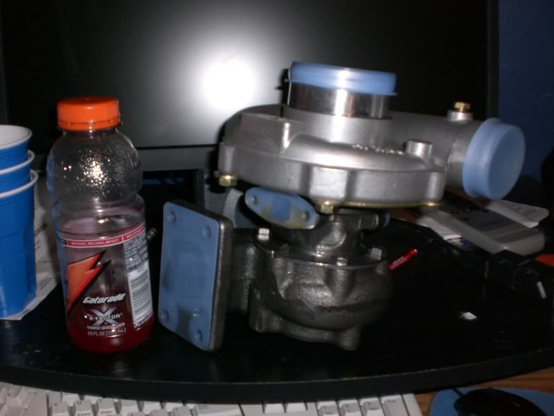

    I know its a cheap turbo,dont waste your money. But I got a oil restrictor so hopfully itl last a little longer than normal.
    shot just for fun.

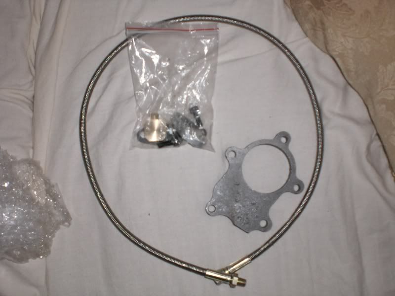

    SS oil line 41"(long enough?) all the fittings, and 5bolt downpipe flange.

    That turbo won't last more than 5,000 miles I guarantee it..but g'luck to you anyway Hopefully the compressor and turbine wheels don't fly apart since those turbo's arent balanced well.
    Save up for a Turbonetics turbo..they aren't super expensive.
    Sounds like a fun project though..and the Treadstone Manifolds are really really good quality, very tough and inexpensive.

    very nice..now get a Garrett box that says : Garrett Turbocharger PN: 85235802 T3/T4 .58/.63 AR
    Quote Originally Posted by thedream2147
    ha i know i opend the ups box and saw garrett and iwas like um? they send me the wrong thing?! ha but nah-is TiAl owned by garrett?

    No..they just have a close partnership..Tial uses Garrett turbo's for their turbo systems and Garrett in turn pushes Tial wastegates. They are an authorized dealer/vendor for each other.

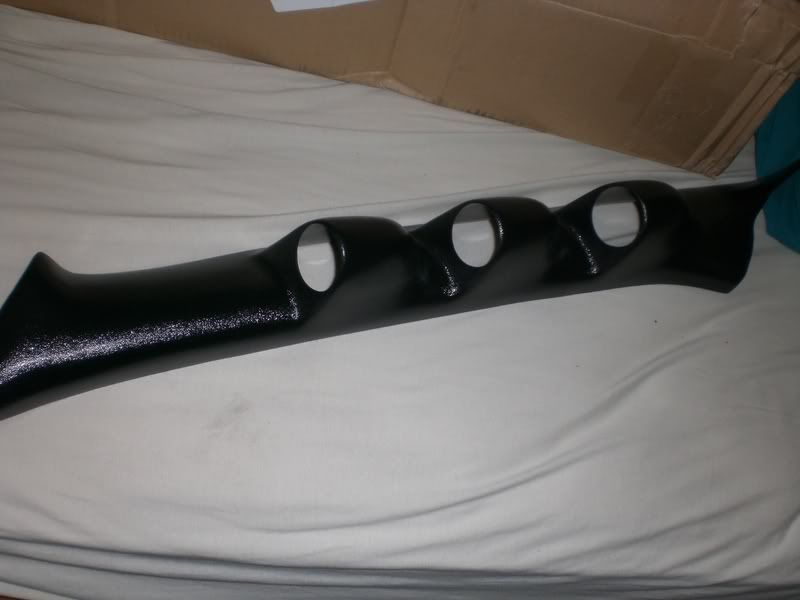

    • 3pod pillar-still waiting

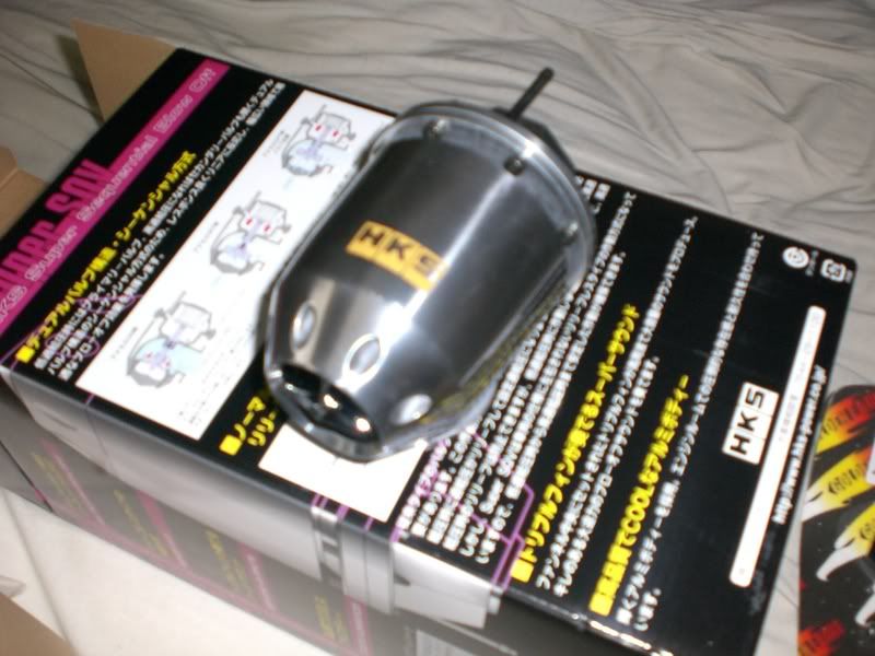

    HKS BOV!
    Authintic no Knock off here.

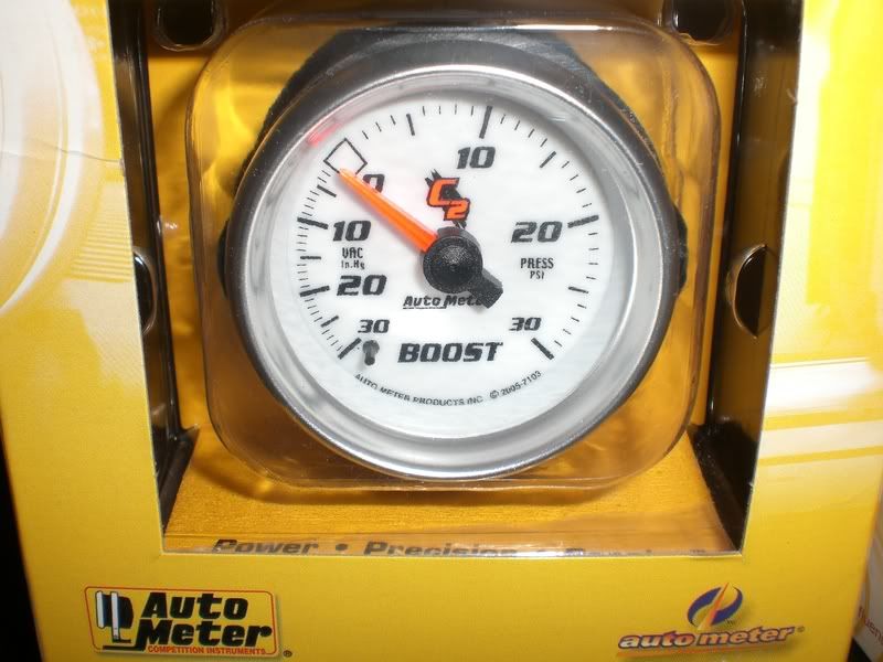

    Autometer C2 series vacuum/boost gauge
    Autometer C2 Oil pressure gauge.

    3pod pillar

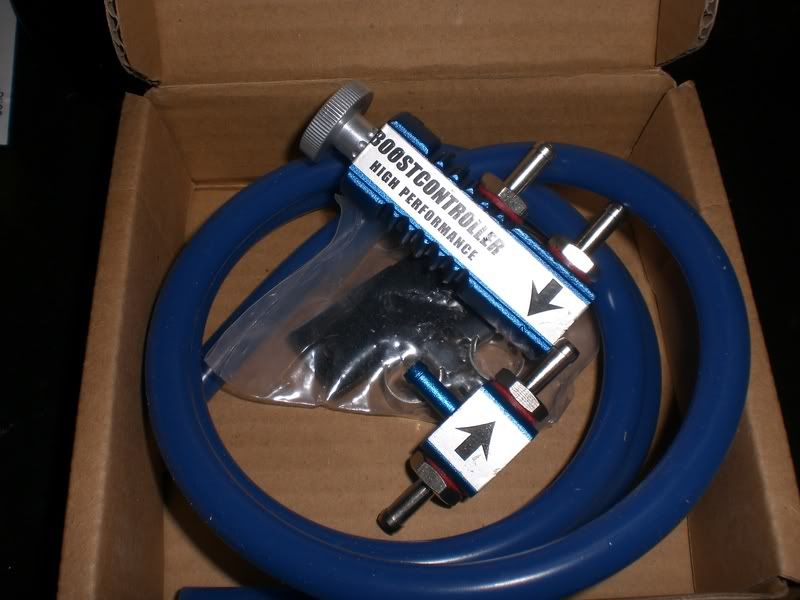

    and a manual boost controller..

    that boost controller looks like the ones on egay?
    Quote Originally Posted by osiriskidd
    ya it came with the intercooler. also from ebay.but o well iv heard they do fine(intercooler that is)
    im going to run just off the wastegate spring.
