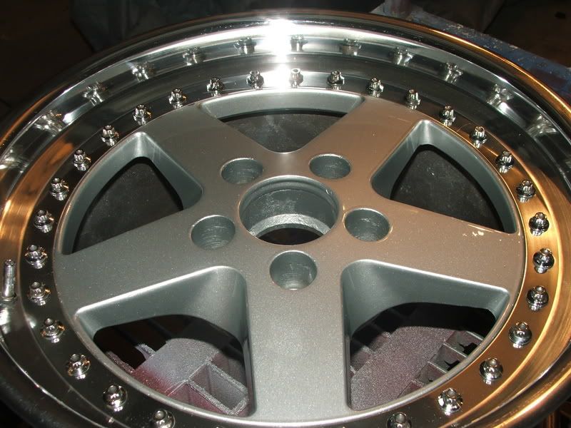

DAMN SON... thats a serious restore very nice

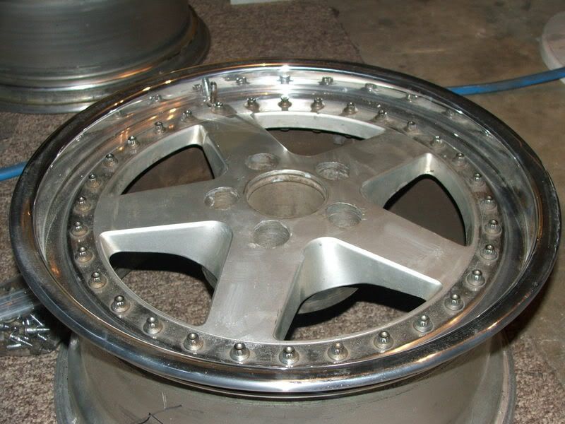

looks good. that's a lot of patience you got! can you repair bent rims?
i can fix curbage but no bends

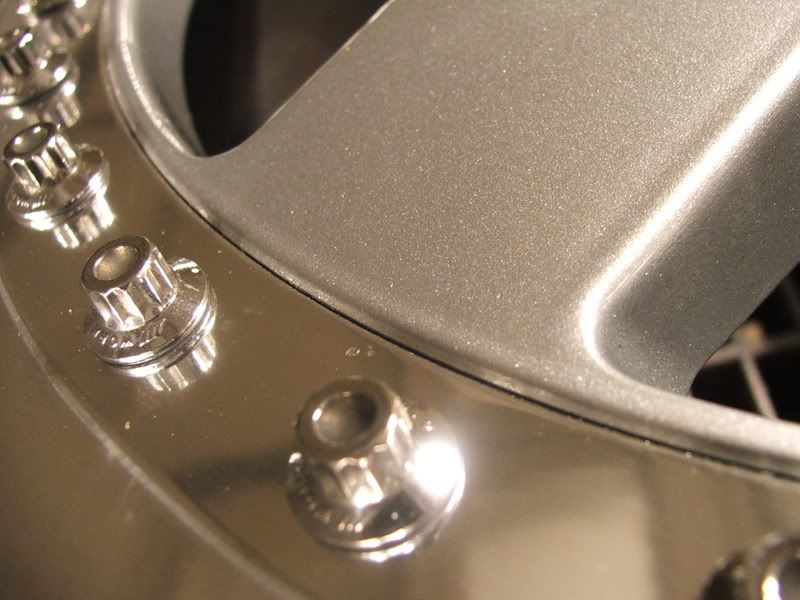

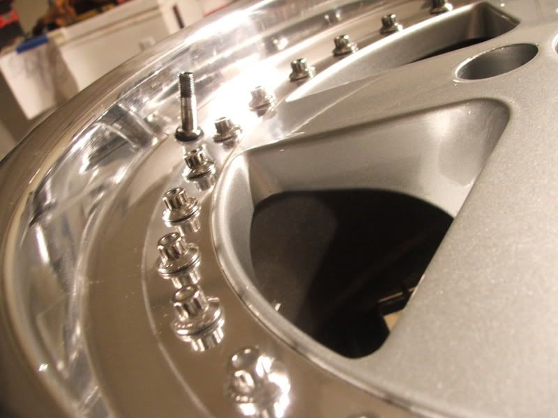

polishing individual bolts
ok, now that's definitely some patients! props to you haha

damn.. your work is always admirable.. as soon as i need something painted, ima let you kowrep
you shoulda charge 5 bucks a bolt! eff that. that musta taken soo long :P
how many ft. lbs. are you re-torquing those bolts to???
gonna do 25ft-lbs until i know otherwise. and let the owner find the correct amount
depends on what the job is
i heard from somewhere its 43ft. lbs for 2 pc. wheelsOriginally Posted by The BUCKY
kool. i will prob research it some for the owner before i torque them down
thats cool. just a heads up.Excellent job on the restore BTW

Modular Wheel Inspection and Maintenance
Two & Three piece modular wheels require periodic maintenance. You'll want to work out your own maintenance schedule, but here's an example of what the manufacturer recommends.
Each Season disassemble, thoroughly inspect, clean, re-seal, and re-torque each wheel:
Replace wheel bolts each season
Wheel Bolt Torque:
1/4" bolts 15 ft/lbs. or 180 in./lbs
5/16" bolts 20 ft/lbs.
After thoroughly cleaning all mating surfaces with an appropriate cleaner, add a thin skim coat of silicone sealant to these surfaces, assemble wheel and torque bolts to recommended torque
Install a new valve stem
Add a thick coat of silicone sealant to the drop center area of the wheel and let it cure for 24 hours before initial use
