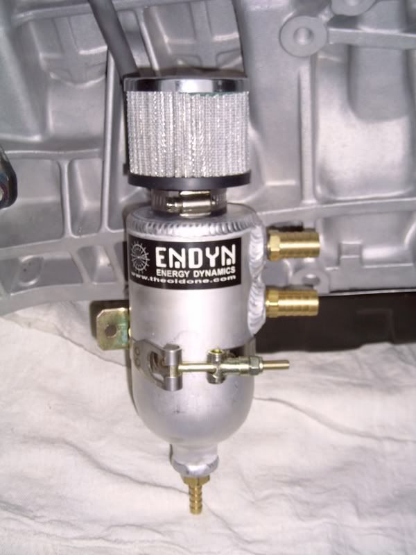

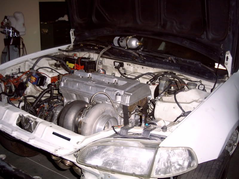

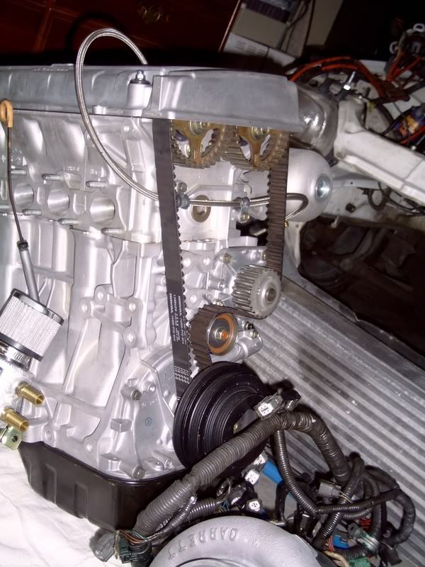

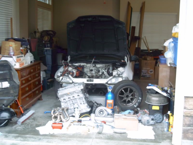

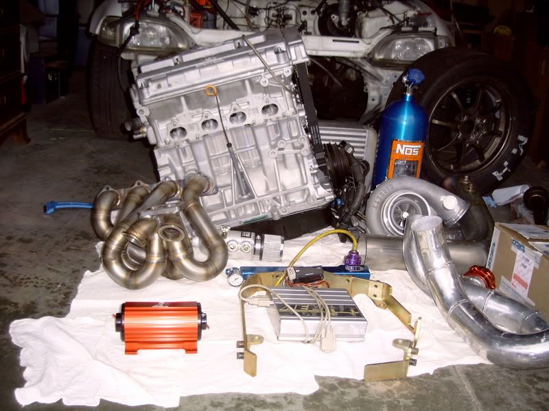

    Well a LOT has been changed since the last time I made a thread about my OWN personal build so here it is! We are pushing for 850whp off the bottle and maybe 900ish on the bottle. I HOPE anyways. Who knows until I actually get it running and get her on the dyno!!! We will conservatively tune it to 20-25psi on the dyno then slowly crank up the boost at the track and tune off data logging. Should be a very fun experience! Cant wait...
    Here's a parts breakdown of the build and the list just keeps getting longer everyday...lmao! Here it goes:
    BLOCK:
    b18c1 w/ 81.5mm Darton sleeves
    JDM P73 Type-R knife edged crank
    Full-Race Manley Turbo Tuff Rods
    Clevite H-bearings
    81.5mm CP pistons with upgraded wristpins
    JDM P73 OEM oil pump
    JDM P73 OEM water pump
    AEBS head studs
    Endyn breather catch can kit x2
    Kept the GE ls/vtec coversion kit for this certain build
    HEAD:
    b16a3 Ported and Polished head
    GSR camshafts
    SuperTech valve springs/retainers
    SuperTech Black Nitride coated intake valves
    Supertech Inconel exhaust valves
    Bronze valve guides
    P72 OEM timing belt
    OEM upper/lower gasket kits
    JG Victor X intake manifold
    FUEL SYSTEM COMPONENTS:
    STR fuel rail
    STR 68mm throttle body
    Precision 1600cc low impedance fuel injectors
    Aeromotive Eliminator fuel pump
    Aeromotive 100-Micron Stainless Element fuel filters (one before and after the fuel pump)
    Aeromotive A1000 fuel pressure regulator
    Full-Race fuel tank Sump
    S.S. -10 feed & -8 return fuel lines
    MANIFOLD AND TURBO SPECS:
    Full-Race ProAm (topmount) divided housing turbo manifold
    Garrett GT4294r 1.01 a/r
    3” IC piping
    2 44mm Tial wastegates (Red)
    50mm Tial blow off valve
    Precision 750hp intercooler
    TurboXS Quad stage boost controller
    AEM 5 bar map sensor
    DRIVETRAIN:
    GSR Hydro tranny w/obx diff
    Tilton twin disc clutch kit
    Tilton throwout bearing kit
    Full-Race traction bars
    Omnipower drag coilover set
    GE scatter shield
    New set of MT ET streets coming
    ENGINE MANAGEMENT:
    AEM EMS(Maybe Neptune soon!!! )
    Wheels and Slicks:
    Weld Magnum 2 piece(Silver outer & Gold center) 15x8’ front w/ 24.5x8.5x15 M&H slicks
    Weld Magnum 1 piece (Gold) 15x3.5 Rear skinnies w/ M&H 15x5.5 tires
    EXTRAS NOT LISTED ABOVE:
    4” down pipe and full exhaust w/ Burns muffler
    Simpsons Parachute kit
    Full-Race 6 point roll cage
    Simpsons Window Net
    MSD 6A
    MSD HVC2 coil

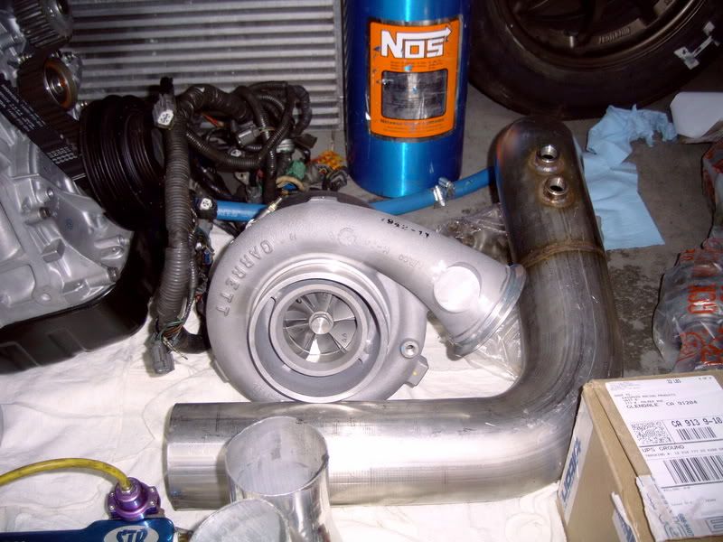

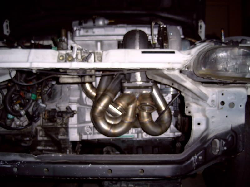

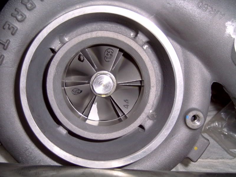

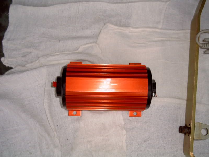

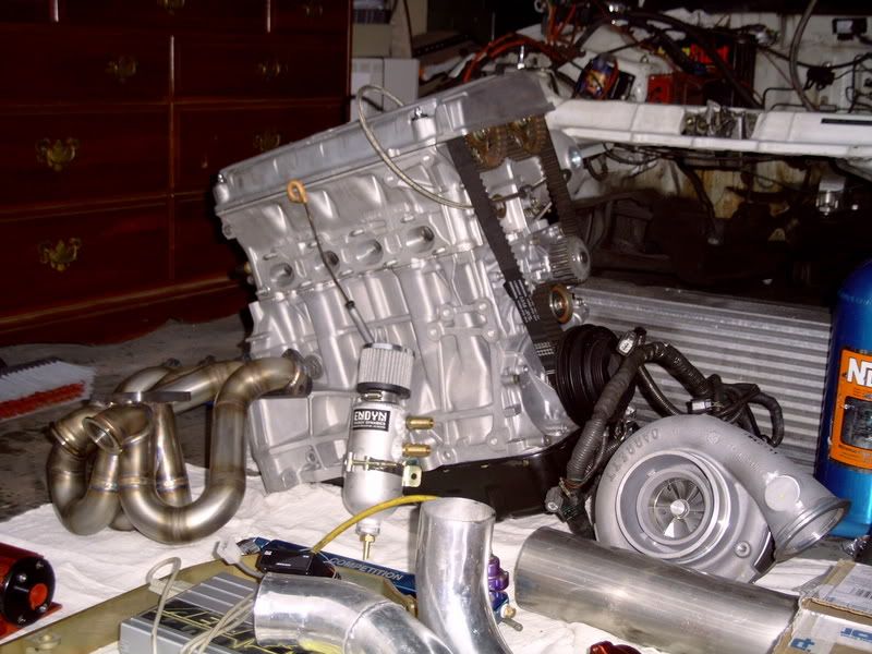

    Here's a few pics I snapped. I just went to Cortneys Greens house the day before yesterday to finnally pickup this engine and I cant even put into word what the engine looks like! Its GOLD to me.
    Tell me what you all think:

    Anyways, Here is where I am sitting at as of right now. Got the engine installed and the turbo/manifold mocked up for a few pics...:
