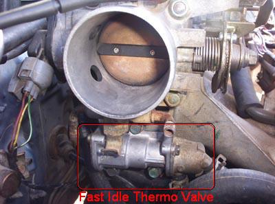

    Here is a picture of the FITV

    We will begin by removing your intake from the throttle body. Now you should see two holes on the inside of the throttle body, we will be working with the bottom one. Here is a picture of the actual throttle body (it is not of my car, as I did this fix last week, I found this picture on the internet, but it should do fine.)
    Once you have done this start your car and let it warm up. When it is warm enough to where it would be good to drive, put your finger on the FITV hole in the Throttle body, as seen in the picture. If it still has suction then that means, the FITV is the source of your idling problem. If not, then try cleaning the mesh on your idle air control valve, replace the TPS, or check for a vacuum leak. But if this is your problem read on! J

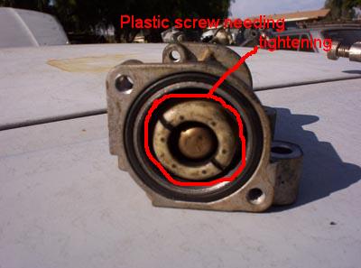

    Step 4- Look at the front of the FITV which should look like this.
    Take the two screws that you see off along with the plate. Now you should see the plastic screw that we have been hunting for. Here’s the pic.
    Now what you need to do now is tighten that screw until it stops. Don’t tighten it too much, just enough to where it is snug with the lower part. This plastic screw, limits how far the piston inside can travel. This is done so the car can idle higher, in turn warming up faster.
