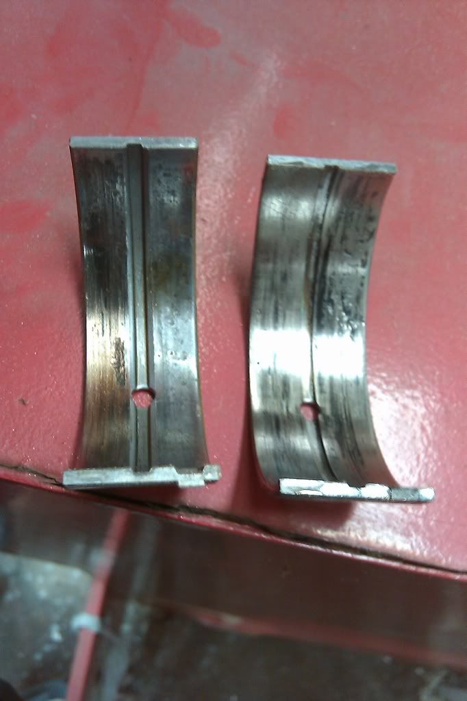

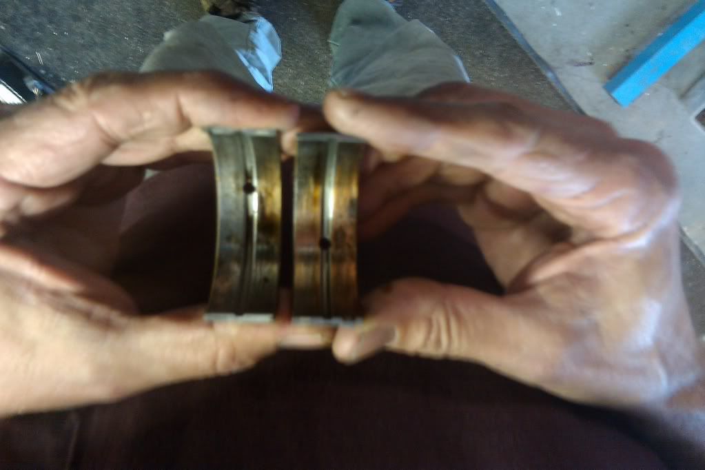

    The lock is still on one bearing and not on the other. Also you can see wear the one with the lock gone has spun were the other hasnt . Tell me how you get one bearing that has spun and one bearing that has a good lock on the same main lobe of the crank ? Im guessing motor started nocking so bottom bearings were replaced so car would run long enough to sell. Just my opinon other ideas are welcome but before you say the bearing was put it backwards there for collasping the lock you would be wrong . The top bearing has spun before just not with the bottom half thats in the motor.

    looks to be a ton of wear on one side of the bearing more than the other. Thrush washers put in backwards? or not even existent?
    that would cause the side to side movement and cause uneven wear.

    Someone did not check the clearances, ether the bearings where wrong or the maincaps where swapped and /or TQ was to much.. Etherway that is some shit..

    The bearing with the lock gone has spun in this motor before while the other one hasnt . This would be normal if this wasnt the same bearing in the same journal .
    Most people dont realize you can change the top and the bottom bearing with out pulling the crank . Looks like to me this motor spun the center main bearing so someone dropped the cradle and replaced the bottom side with out replacing the top side . This is why one half the bearing has the lock gone and the other side doesnt . Who ever did this didnt do it thinking they fixed the problem but rather did it in order to sell the car with out replacing the motor.

    I didn't understand what you meant when you said the lock was gone but now I see it. The tab is rounded off on the right bearing.
    Like Bobby said clearances look like it was way too tight or it was starved for oil. Hard to get clearances that far off if it's oem bearings because they are generally in the middle (green).
    Or it spun a bearing before and damaged the rod/crank and they just slapped new ones in and didn't resize the rod.
    If you can hear a motor knocking, it's trash (at least the rods and crank are usually)

    Block and crank are trashed no doubt . I doubt they checked clearences while they were putting half a bearing on a already spun crank lol.
