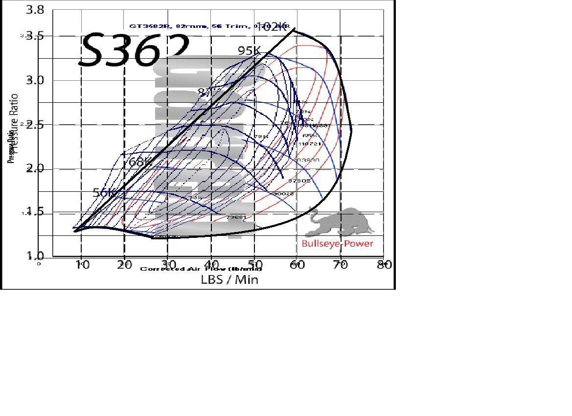

    It is a Bullseye S362...kind of hard to describe the size. It is a hybrid turbo with a T3 sized turbine with a BIG compressor. Little larger than a garrett 4088R. Nice part is it spools up quicker than a 35R!! Here is a comparison of the compressor maps.

    Quote Originally Posted by crashtke View Post
    Your the first one that I've seen that uses the map... Beautiful setup BTW... I'd fuck it...Lol

    Some say that it is just not important, but for me it seems to give me a good idea of how the turbo will perform and what it is capable of. Really hoping to break 500 AWHP (all wheel horsepower to those new to the awd world) with this one on pump and a 75-25 mix of meth and water.
