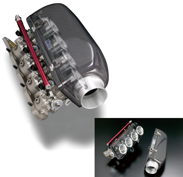

    Default Oh my jeebus I want
    http://www.todaracing.com/en/product...tion/f20c.html
    Anyone got 6 grand they wanna part with...

    that is sexxxy..

    another fine part for honda products, that costs twice as much ad the honda.

    not 6k sexy...

    Nope, just half as much

    you can get a set of jenveys for half that price and they are just as nice if not nicer

    there are quite a few companies that have ITB set-ups for the S2k.
    TWM has the introduction kit for the S2k. Good starting point, but hasn't shown the gains as some of the higher end pieces. But, it's also a lot less of the price, hence introduction piece.

    u crazy not worth it to me for 15 hp

    looks good but FUCK THAT PRICE! holy chit!

    psh, closed air boxes are for faeries

    Sorry my stacks run over gravel, tarmac and snow. Airfilter needed.

    theyre not on the bottom of your motor, you'll be absolutely fine

    Running a BMW with open stacks that see's four seasons of the year and several miles of long dirt roads and driveways in the N. Ga mountains more than 2x a month is absolute suicide. There is a reason Alpha-N cars are typically for the track only. Plus, the resonance the box makes is a way cooler sound than running them open

    Itbs=most overrated na part known to man. It's the new Jdm fanboy ricer part
    looks cool and sounds cool but for 99% of the honda world they are a waste of money. Gixxer1000s are too small anyway. It's all a out size and depth . Most people just think omg itbs!!!! Toda b series itbs suck and cost people power not add. Ask black r and Len
    Len had vtec killers ctr pistons toda itbs and aem in his itr motor and made like 205whp lol. He was pissed

    If you are building a 15:1 compression race motor thn yeah jenveys or the kinslers are what you should be running not an off the shelf edelbrock manifold.
    99% of people think itbs=mad horsepower
    they don't give you tons of peak hp they give you lots of midrange. They were designed for road racing not drag racing. However in a 15:1 drag motor they work when properly sized as they feed more air than a standard plenum can.
    Toda itbs on an s2000 is gay. Stock motor would see like a 1-10whp gain for $6000. Not so "sick" IMO

    i agree with you completely, i was just poking fun. ITB's in my opinion are utilized for throttle response and high end power used in road racing. but yes, the S2k with tuning sees about 20whp from ITB's from what I can remember.

    but they are definately not for stock engines they might make better midrange but as far as peak goes they normally only make around 5-10hp the midrange torque is where it's at. my car made 16ftlb's of torque over a edelbrock performer x and 10 peak hp over the same manifold.
    they can be a huge pain in the ass to tune and for power the injector needs to be placed as far away from the head as possible but the same thing that makes extra power hurts drivability alot. so it's not really worth it for most engine setups

    who gives a shit about practicality and useable hp? This thing is sick and if you have $6k to drop for 10hp on a $15k car, you probably have everything else you could want/need.
