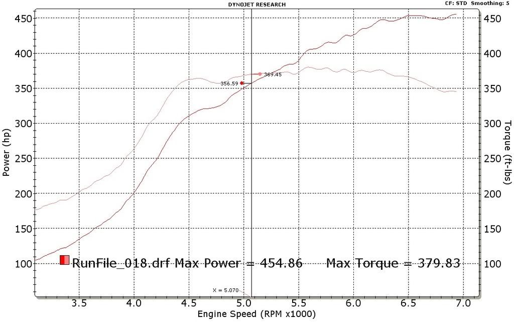

    Scotty just finished doing a base breakin tune on JDM-STI'S car. Again we are amazed by what a flat tq curve we were able to achieve with our new motor package.
    Peak boost was set at 20psi falling to around 18.5psi at redline. Run was made on straight 93oct. No other octane booster or adder was used. This car clearly has a high 400hp run on just pumpgas in it once some more miles are racked up, and we up the tune to something a bit more aggressive.
    Turboxs fmic
    UR gt35r .82ar
    Hydra EMS
    3" non-catted exh
    deatschwerks 850's
    Topspeed RR1 long block
    Cosworth Cams
    Ported stock headers
    Grimmspeed X-over pipe.

    520whp/462wtq (file 41) on 93 octane and 75/25 meth/water mix. 26.5 peak psi tapering to 23 psi at redline. More to came after the AVCR install. The Hallman manual wouldn't hold much more at redline on the dyno.
    Break in was done with a .82ar hotside and the high boost was done with the .63ar. You can see the difference down low without much change up top. Run file 18 (.82ar) and 27 (.62ar) were identical as far as boost and timing and almost identical on the graph except for down low. The difference down low is night and day on the street.
