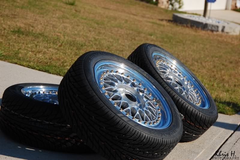

    Some of the polishing work ive done..
    My well known SI..
    OG-Sans
    Before:
    After:
    Dirty Octopus' BBS RS lips
    Before on the RIGHT and After on the LEFT

    very nice!! great thread!!
