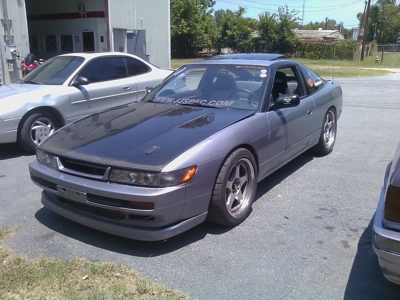

    Only decent pic I have of my polished Nismo GT2's. They were a lil dirty after having the tires mounted, haha.
    Before the alignment, hence the messed up rear camber...
    EDIT: Another dirty pic...waiting on Chris to upload some pics from earlier today...

    Quote Originally Posted by AFSil80 View Post
    clean azz sylvia mann.. nice rims as well

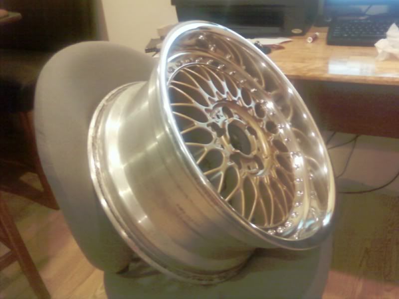

    I never realized i hated sanding so much till i polished some wheels. 2 down 2 to go.
    320-400-600-800-1000-1200-1500-2000 then compound with a ball then polish by hand
