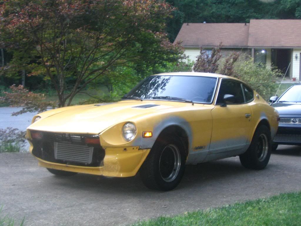

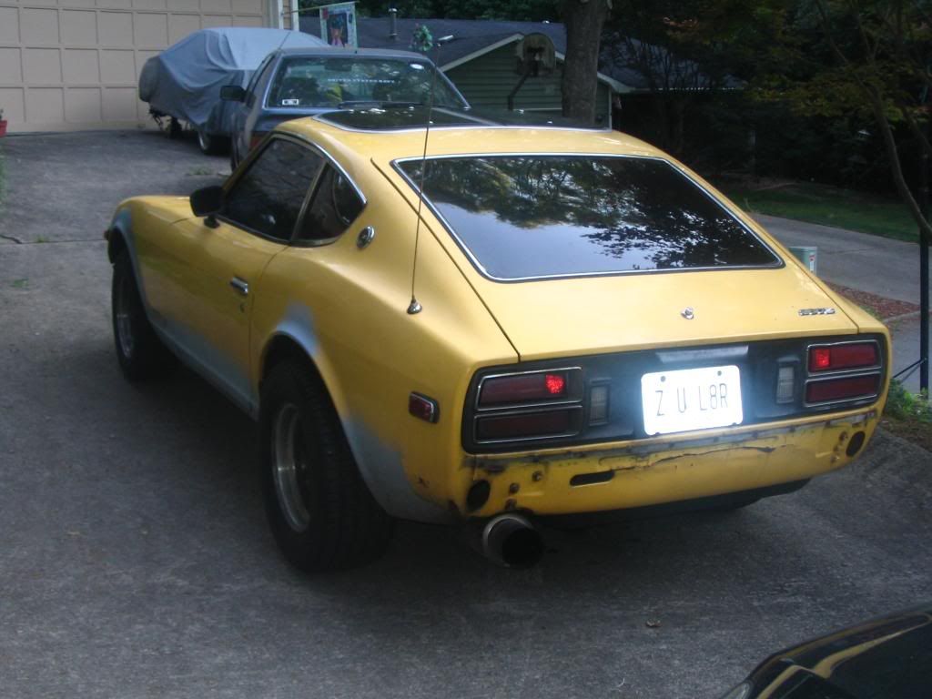

Sold the car to a close friend of mine. Here is the list of the mods it had, in case someone has similar goals in mind or u were just curious to wtf i had done to it.
