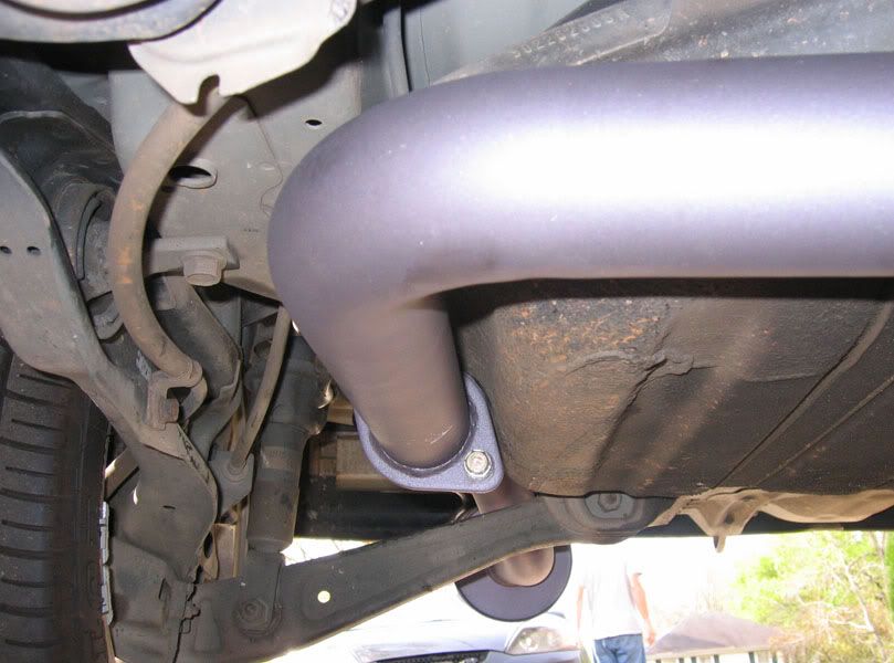

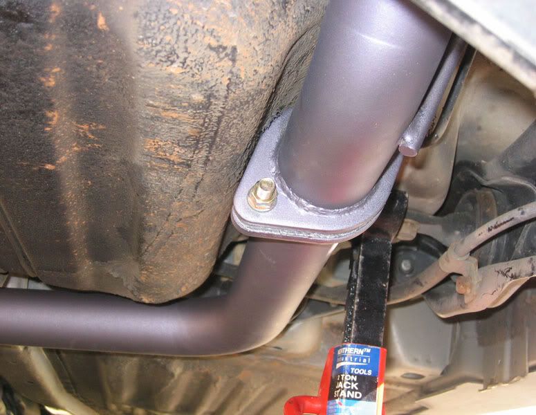

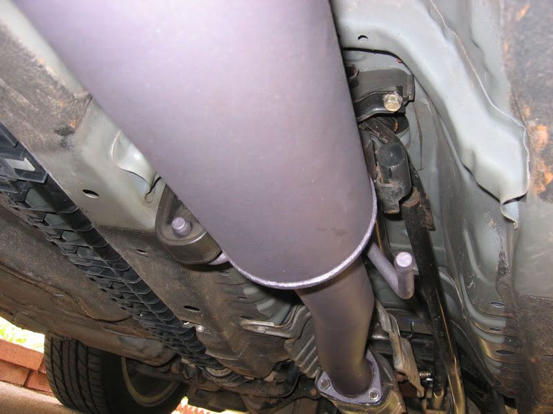

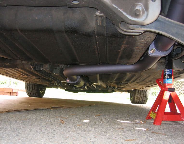

    Problem: The exhaust rattles against the bottom of the car where the muffler is conneted to the piping
    Questions:
    Is it mounted incorrectly? Because its not at an angled as I was expecting
    The hole on the tip where the screw holds the silencer is to the right..which is thought was directly up and down
    How many rubber hangers are on the EX/SI Model?
    I remember 5 Rubber Hangers on the EX
    2 on the muffler
    1 on the piping that connets to the muffler
    1 Near the cat to the piping
    There is an extra hook on the exhaust that seems like i am missing another hanger but there is no where to attach it to...below are pictures to help you understand
    appreciate any help
    i am jill's nipple. fight club's Avatar
    Gwinnett ftw!
    3,210
    first id reccommend taking the heat shroud off cuz that could be vibrating. also, from the pictures, it looks like ur muffler section is upside down. my n1 hung down not up, by that i mean the hangers should go from the rubber pieces down to the muffler, not up to the muffler. try to rotate it around. also, ur last missing rubber piece should be on the right side of the muffler. it seems u are missing that.

    i know what rattles..ad its the part where the muffler is connected t the piping....its shown in the picture

    hahah in the pic of the muffler, your missing the rubber hanging thing, i call that a grommett. if i saw it in real life i could prolly help more as i had this exact exaust and had no fitment issues.
    When I was a child, I used to talk as a child, think as a child, reason as a child; when I became a man, I put aside childish things.
    IA Senior Member CiVeK9's Avatar
    2,119
    nope..i am not missing a hanger..confirmed in on honda-tech...same issue with greddy evo exhaust...all SOHC owners have 1 less hanger..i just have to adjust the exhaust..and maybe try a different combination so that the back doesn't rub..

    hmmmm, interesting. try flippin ur muffler section. just an idea.

    and after some research on Honda Tech and talking to Scotty at mainstream...the civics only have 1 hanging on the mid pipe...
    all i have to do is loosen or tighten the bolts to make any adjustments and also swap the pipe ends..because it can be bolted on backwards and thats probably hte main problem
    thanks for all the input guys..i will post pics and the solotion to this once its done

    cause thats not the issue..its just that one of the pipings is on backwards..i have two buddies with the same exhaust but both on SI...and it fit perfect...its jsut a matter of aligning it correctly...easy..fix
