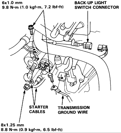

    4. Disconnect the starter motor cables, transmission ground wire and back-up light switch connector.

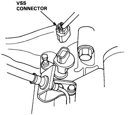

    Disconnect the Vehicle Speed Sensor (VSS) connector.

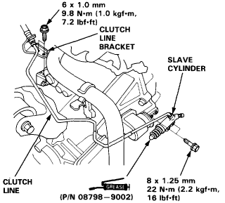

    7. Remove the clutch line bracket, clutch line clamp, and slave cylinder. CAUTION:
    o Do not operate the clutch pedal once the slave cylinder has been removed.
    o Take care not to bend the clutch line.

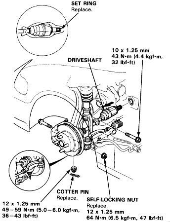

    Remove the driveshafts. NOTE: Coat all the precision finished surfaces with clean engine oil or grease.
    Tie plastic bags over the driveshaft ends.

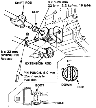

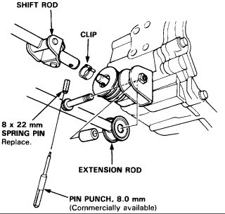

    Remove the shift rod and extension rod.

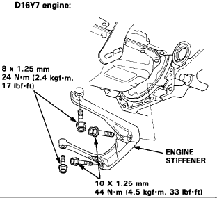

    Remove the engine stiffeners and clutch cover.

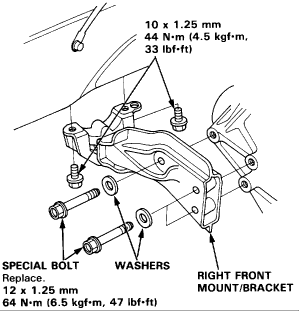

    14. Remove the right front mount/bracket.

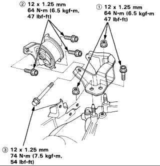

    Remove the transmission mount bracket and mount.

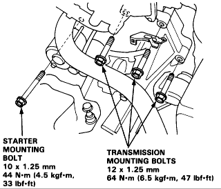

    Remove the three upper transmission mounting bolts and the lower starter mounting bolt.

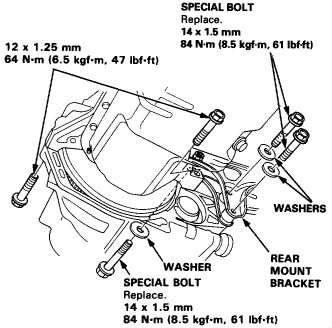

    18. Remove the rear mount bracket bolts and transmission mounting bolts.

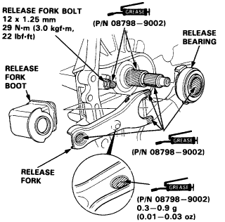

    2. Remove release fork from clutch housing by squeezing release fork set spring with pliers.
    3. Check release bearing for excessive play and roughness, then replace if necessary.

    * Apply grease to the parts as shown, then install the release fork and release bearing.

    lol thats what i looked like when i pulled it but. but most of the pix are just to id nuts and bolts.
