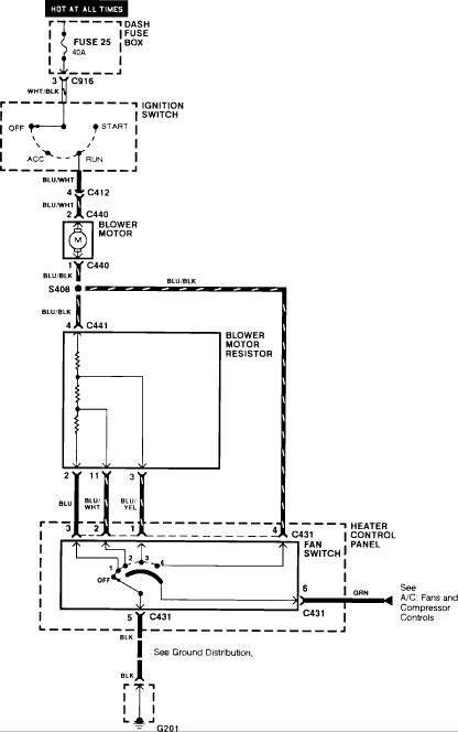

    so my problem is that the blower motor(interior) has completely stopped working. i know why but i cant find a solution.
    the power and ground wires leading into the blower motor touched together and thats when the motor quit working.
    ive pulled out the blower motor, checked the BM resistor and changed it out for a working one, i checked the fuses (they were good), tested the BM to see if it works( it does), and used a test light to see ifi was getting any power on the power wire(no luck)
    so..im not getting any power to the motor. and its hot outside..and ideas or tips would be appreciated..and repped.

    if u got power to the wires but power into the BM. u got a brake in the line from when they touched. find the highest point with power. u will after the brake someplace around there.

    well im not getting power at all as far as i can tell is the problem. i used a D battery to test the motor i just touched it to the spots on the power and ground wires that were bare, and it kicked on. i tested it like that as far up as i could access the wires.(only about a foot)

    find the blower motor relay and check power on it...

    pretty much i would follow the path...

    awesome...thats what ive been looking for, thanks.

    where was the failure.
    shit..no 6th.. chip P.'s Avatar
    athens
    607
    i checked the #25 fuse and that was it. it was bad. its the starter relay fuse...weird

    i just reread that #25 is for the ignition switch. if that was blown there should have been a lot more than just the blower fucked up.
