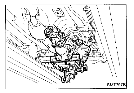

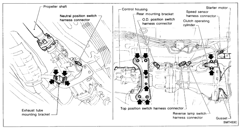

first tip is to get u a manual.
* Remove clutch operating cylinder from transmission.
* Disconnect speed sensor, O.D. position switch, top (4th) position switch, reverse lamp switch and neutral position switch harness connectors.
* Remove starter motor from transmission.
* Remove propeller shaft. - Refer to section.
* Insert plug into rear oil seal after removing propeller shaft.
* Be careful not to damage spline, sleeve yoke and rear oil seal when removing propeller shaft.
* Remove exhaust tube mounting bracket from transmission.
* Support manual transmission with a jack.
* Remove rear mounting bracket.
* Lower manual transmission as much as possible.
* Remove shift lever with control housing from transmission.
