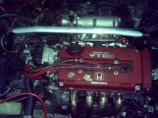

    F.A.N.A.T.I.C. primespark22's Avatar
    519
    ok here is a crappy night time cellphone pic can anyone tell me gsr or type r

    Southside Ridin HATCH
    9,812
    ^ ITR!!

    Nov 2003
    22,589
    Both Type-R and SiR-G have the B18c code.
    Quote Originally Posted by primespark22
    http://i393.photobucket.com/albums/pp13/primespark/PIC01006.jpg
    The intake manifold and valve cover would imply it's a B18c Type-R but would have to looking at the stampings to know for sure. The transmission will have LSD painted/stamped on top if it's a Type-R. I'll trade you a '01 GS-R transmission for it if it is!
