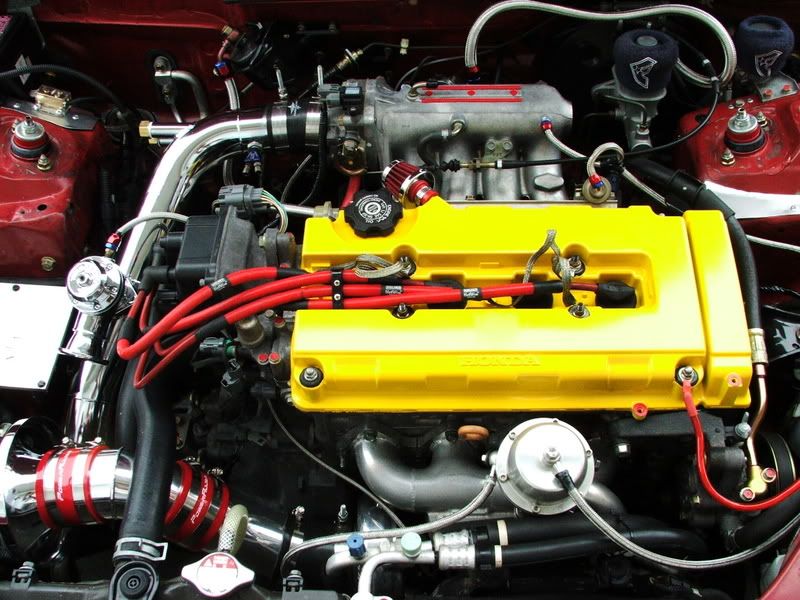

    i am thinking about buying a b16a2 from a guy and it runs strong but on the back of the valve cover where the nipple is, oil come's out there. what would cause this. i was told maybe the pcv valve is clogged up but i dont know. any help will be repped.

    wow....honestly man your gonna have to supply us with pics to fully understand what you talking about. If it is coming from the valve cover, might just be the VC gasket.

    see the little air filter on the back of the valve cover. thats where the oil is coming from.

    lol stupid question is it over filled with oil

    check ur oil level like no mo hondas said its probubly over filled

    take off filter see if appendage is crackedor c if clamp is loose. if its under that its vc gasket.

    If it is coming from there and your oil level is correct, then it is just your vc gasket like ^^^ said

    never mind, the retard said he for got to put the seals under the bolt's when he changed his valve cover gasket. and i think he is using the "my mom wont let me sell you the motor" excuss.
