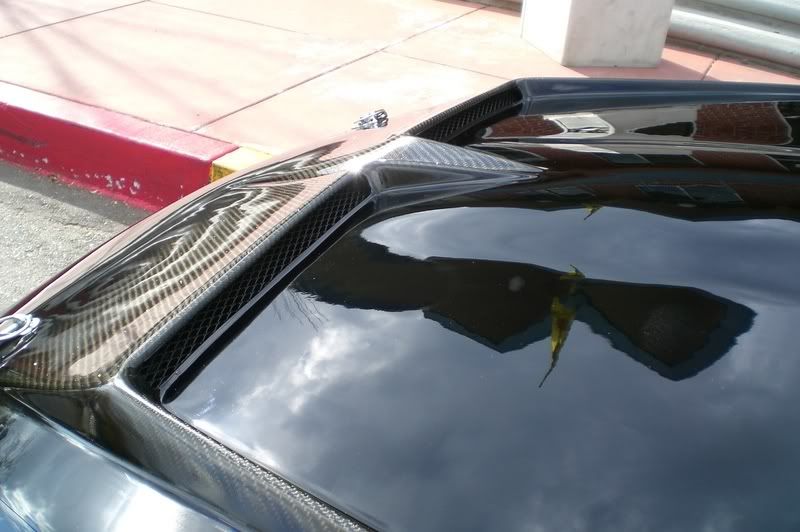

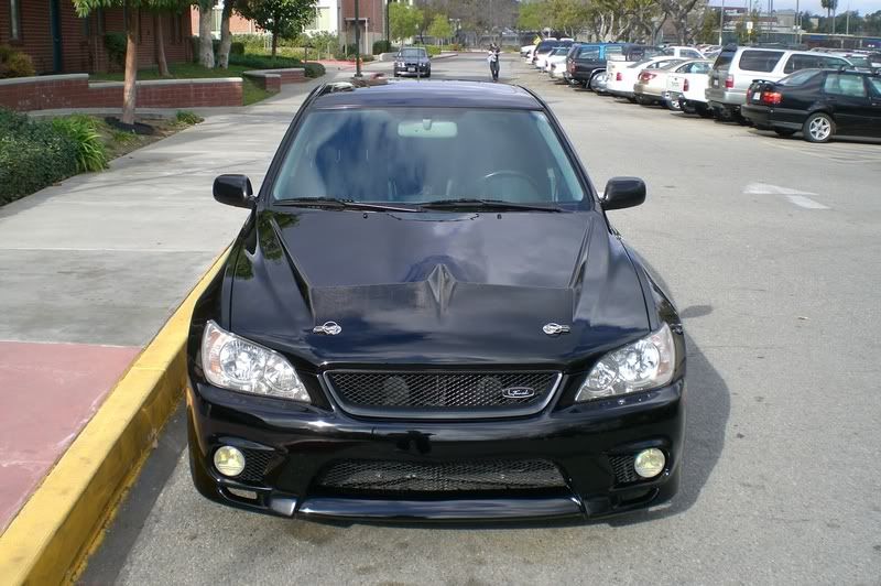

    So I've always consider getting a cf hood but I dont wanna be like one of those carbon fiber freaks that replaces all of their body panel with cf and leave them unpainted for the "panda' look.
    I've seen a hood painted along the line of the body like this:
    OR completely painted over into a fade like this:
    My question is: How hard is it to put a coat of translucent paint over the carbon fiber? I want the hood to blend in with the rest of the car and not be too noticeable but then again... I want to still see the weaves when you get up close. Would it be a special paint or just a single EVEN coat of paint? Would the painting process be the same? About how much would it run me? Painters (i.e. Bucky) please chime in?

    you want the entire hood to be painted? or do you want to leave parts exposed to show its still CF?

    i say running a 2 tone paint scheme would be nice...depending on what the hood looks like have it paint to certain body lines on it. and leave parts unpainted to show the carbonfibergoodness.
    your choice though really, you're the one paying for it so its really up to you on how YOU want it. and the cost should be under 300 just depending on how you want it to look.
