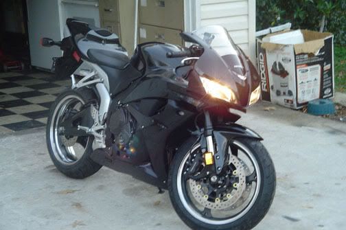

    heres a look at what it did for me, on the left hand side thats circled is what was not done and the rest beside it was done with the rouge and wheels, i found it in the tool department, its by riobi, i used the green colored first, then black and polish it out to a shine with the white rouge, used seperate wheels for each color

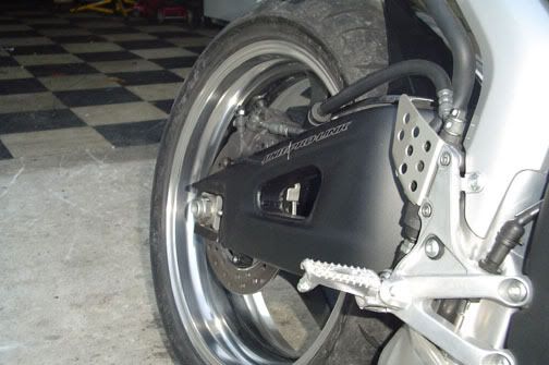

    I've used the power ball works good for me. I used it to polish my bike wheel:
