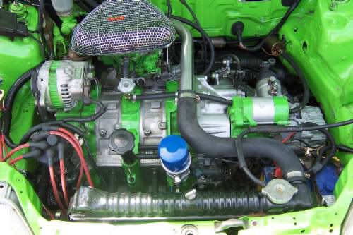

    b20's aren't anything special though... I wanna see a 13B in a fwd civic...lol that'd make my day, you'd get like 13 rep points at least

    Rotary ? That sh!t would rock.

    I want my 13 puntos!!!! Rotary in a 6th gen rhd civic. Not sure about the trans though.
