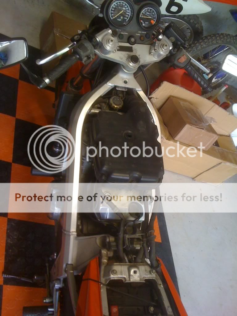

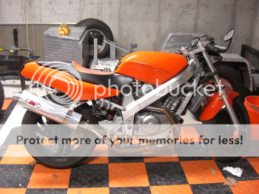

Ditching a lot of old stock parts to give an edge to the old bird -
Lose the original bulky airbox in favor of some UNI Pod filters.
Drop the original wheezing exhaust for a full M4 system!
Along with the filters and exhaust put a Factory 3.0 jet kit in, with carb jetting and the bike runs flawless! No more lean running or stumble in the throttle action! This is why I love Carbs! You only need a screwdriver to work on them! Can be finicky tho..
And get yourself right with the sound of a twin!
