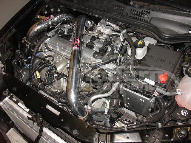

generally what my engine bay looks like but a little narrower and my intake is different (sri). i have the same injen piping tho and i made my sri out of this injen cai.

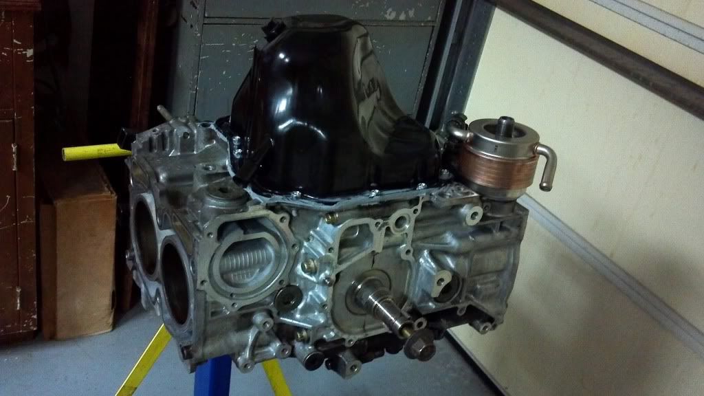

I was busy last night:
http://i284.photobucket.com/albums/l...4-37_894-1.jpg
The gray sealant isn't as messy as it looks.
Nobody in here has 14/15" steelies they want to sell do they?
I know damn open deck 205's.... The bores are in fantastic shape with only 30k miles on it. I wanted to do a set of drop ins, but I just can't get enough miles out of a set. Especially if I'm not gonna machine the block and get perfect PW clearances....
The stock slugs should support the 350whp I plan on making. For awhile anyway. lol
Do it now or kick yourself in the ass later.
At 40k miles a year it wouldn't last but a year to a year and a half... I hope to build something next year (late 2012- early 2013) anyway so I'm not too concerned. I'll roll the dice on the stock internal 205:D
With what you're doing with the car, I could see that. If it was a second car, that ~40k miles could spread over a few years.
exactly. I guess it wasn't until a few days ago that you realized how much I actually drive. lol
I may keep rocking the exploder and dad's car and drive the wagon 2-3 times a week to keep miles down. If i'm successful at that I will be more comfortable with a forged internal motor...
