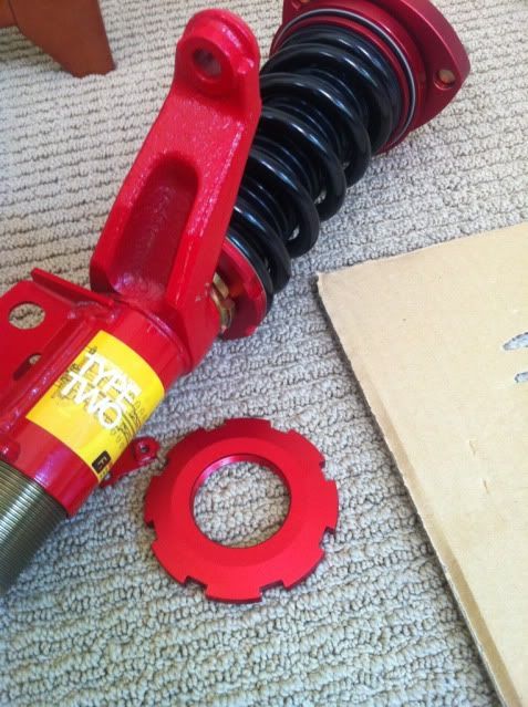

Thursday consisted of my prepping the car for the suspension swap. I hate suspension work and knowing my luck I knew I decided to get ahead of the curve and take the Progress coilovers out a day early in case of issue. As I predicted, one balljoint was seized in the coilover arm while to other balljoint had a spinning stud. After futile attempts to remove even with the help of Mr. Teng, I was forced to cut the balljoints off with the air saw the next day. Of course no Honda/Acura dealer or parts store carried the balljoints on hand :headslap:
Richardson came to the rescue and rush ordered me a set that arrived no more than 3 hours later! These bad boys arrived shortly after.

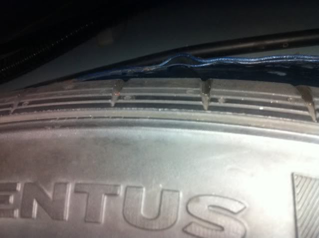

After getting them in David and I literally did DIY alignments for a good hour going anywhere from -10 camber to +5 camber, toe in to toe out, etc. Finally after it was safe to drive I noticed ungodly scrubbing on flat ground, noises, and inability to steer upon cornering.

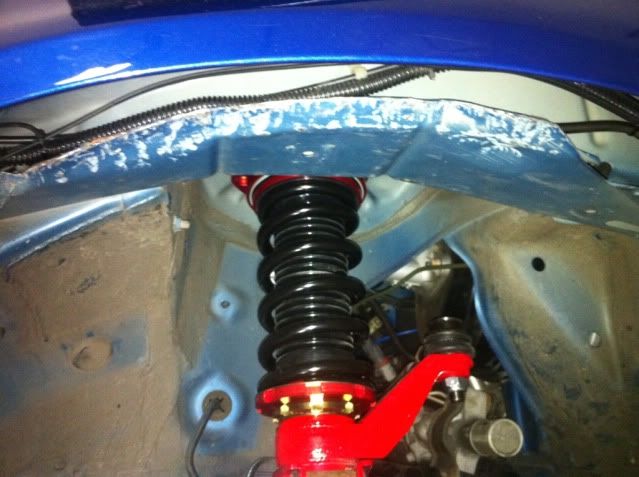

Last night I pulled the fender liners and most issue on flat ground was resolved, however I still had problems with even the slightest bump in the road and any cornering. Here's a picture of the issue....
http://i297.photobucket.com/albums/m...7/dace8eea.jpg

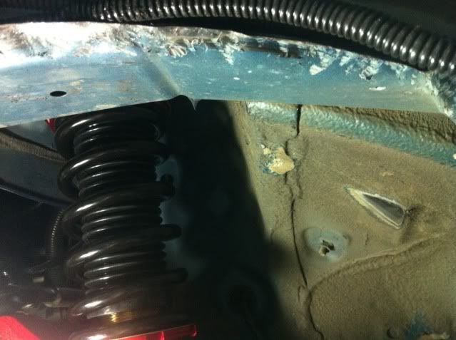

This image is taken inside the fender, that blue metal you see is actually the wheel arch support which is behind your fender liner. The unfortunate solution? Beat the living shit out of it with what Pulzone and I like to call the "special tool", also known as a mini sledge hammer!
http://i297.photobucket.com/albums/m...7/a92195a6.jpg
http://i297.photobucket.com/albums/m...7/dd190a23.jpg
I did give it another go with the hammer after a test drive and beat it senseless more and primed it to prevent rust, just don't have a picture. This time, 90% of the issues were gone, but upon spirited cornering I'm still contacting that metal. The only solution left is to go in with an angle grinder at another point in time. For right now, it's good enough to daily.

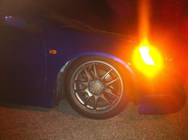

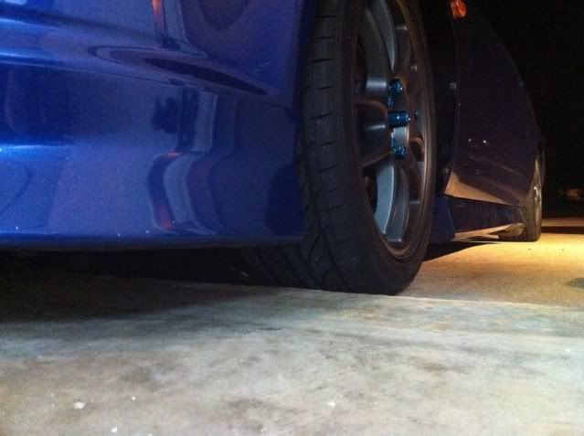

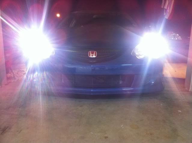

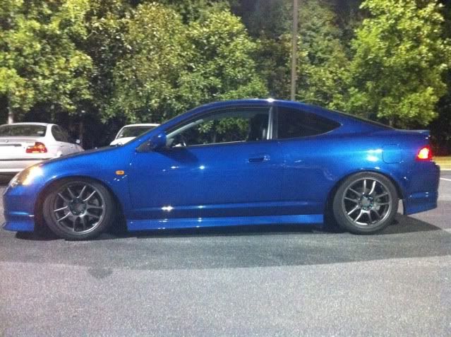

Here are a few shitty night shots of the results so far:

Been debating on putting the halogens back in. So no harm here, lol.
Looks great Danny. There's a list of things i would change but it would be to much of a PITA for you so i'm not gonna complain, lol.
x2
