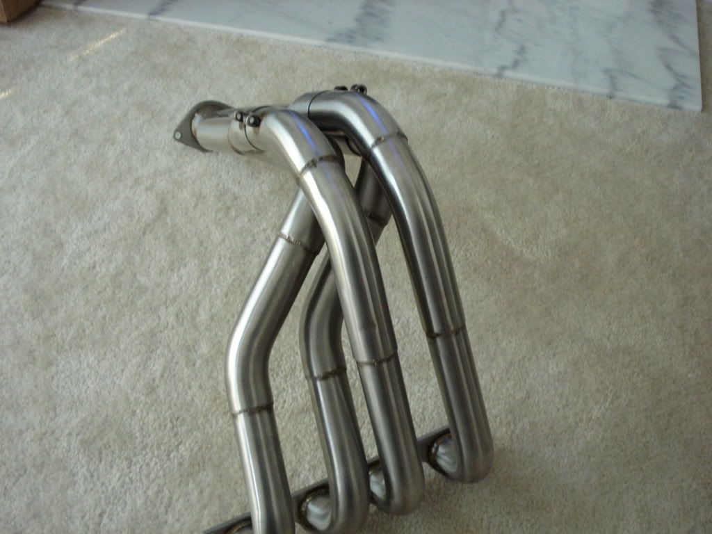

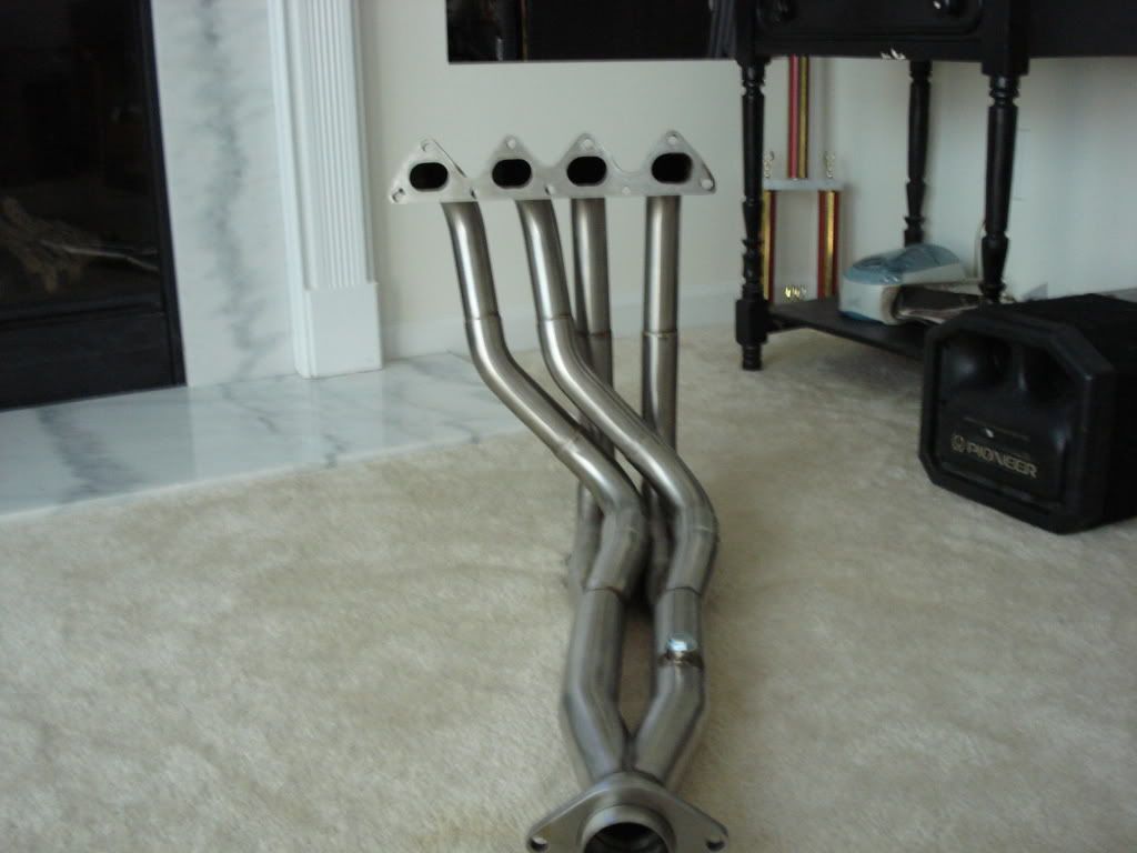

    met up with dare in columubus ga on friday and worked on his car and mine and came up with this for a good 2 days worth of work
    old
    new

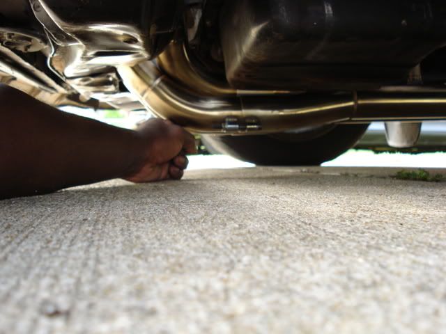

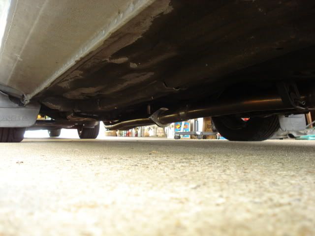

    can def feel the difference this is what it took to make it work

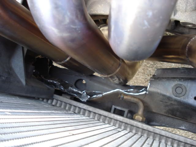

    u need to cut a U shape this is where the dremel and red bull came in took us nearly 8 hours to cut it all out my next upgrade is traction bars for sure

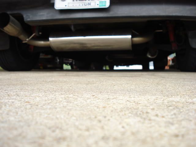

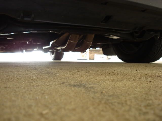

    this is my clearance now

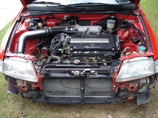

    dare added a velocity stack to his car which improved his airflow here is a side by side view of the old one vs the new one
    if your running the AEM hybrid intake like me and dare and you want to run the larger velocity stack you have to cut about an inch or so of the end of the bottom of the intake piping to clear your bumper

    looks good told you that crossmember is a *****!

    lmao mike yeah im def getting some traction bars soon

    I pray that the bottom of the header doesn't get smashed up in the 1st week. It hangs as low as my 4-1 and I've dented a few of them already, I'm on like my 3rd one. Get Charles at MSPi to make you a skid plate for it ..

    i got a good scrape on teh bottom of it already kevin from somebody driving my car open header lol but its all good im gonna raise my car up a few clicks tomorrow because it does sit low and i will def check into the skid plate do you know how much he charges to make it im gonna buy about 2 more of the headers for my other motors i have so ill get him to make 2 or 3 of the plates

    That won't work because you actually have to cut part of the chassis to get the intake to work and the stack wont fit your intake without a reducer.

    are you talking about that lil hole on the passenger side of the bay?Because I tried to get a intake to fit down there lol.Came to the conclusion it would need some dremel love to get it to work.

    the bumper isn't the problem, it's the air filter cutout.

    Yeah thats what I'm talking about. You got to dremel out the hole a little bit before you install the AEM hybrid intake.
