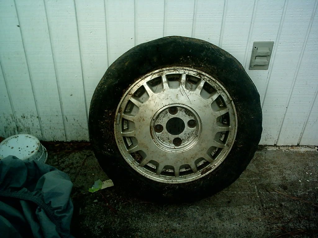

    i found this at school and i am going to find out wat the came off of and go to the junkyard and get the other 3

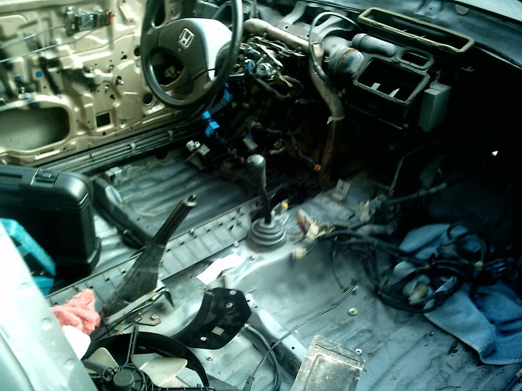

    and here my current state on my interior on new hatch
    here is the interior uin the red civic andi am going to start pulling today

    deep6invested those are the lences
    i am going to clean that wheel now and post a clean pic

    ok sitting up in the dash ok yeah sweet cant wait to get them, that wheel i think ive seen some wheels like that before they were on a civic hatch and they were honda wheels but they said turbo on them somewhere.

    yeah i have enviromental science this year and we were doing a campus cleanupp and it caught my eye so i dug it out of the ground and took it home

    nice what size is the wheel so i can try and ifnd it.

    i think 15

    That wheel is from the 1991 Honda Accord. Later, QD.

    it came off a 91 accord

    The wheel is a 15x5.5" wheel.
    Call your local salvage yard. I did a part look up and there are a shiitload of those wheels there. Ranges from $50 to $100 per wheel.

    it will not fit your hatch

    Lug patterns are different.
    1991 Accord = 4x114.3
    1991 Civic = 4x100
    Later, QD.

    4x114 = EF/4x100

    do the 114 hub conversion.

    ill just stick with steelies for now

    those wheels are heavy as well go with steelies for now or upgrade to 88 prelude mesh wheels for a og look
