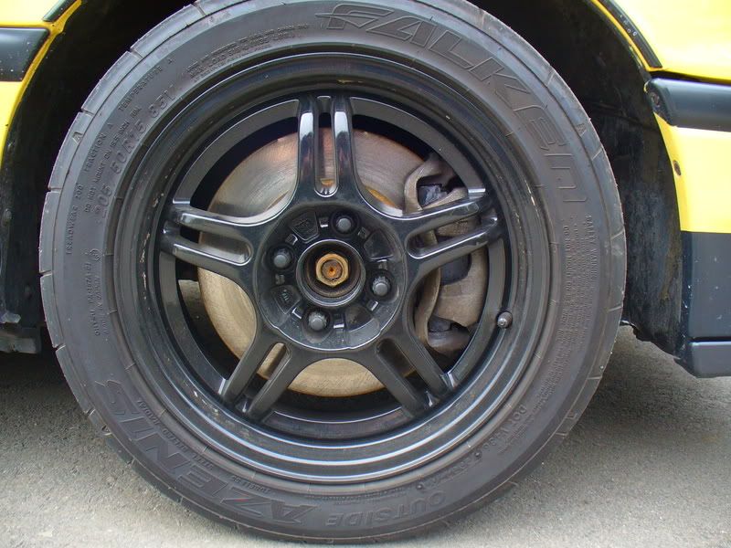

    Well, I'm in the process of doing an 11in brake upgrade and wanted to know if anyone else was interested. It would be similar to Jeff's but without having to pay fastbrakes for the custom bracket and parts. It would also use a much larger caliper. The only thing is this setup would be only for people with DA, SiR, or EX knuckles, and you would have to use 15in wheels. You could get it to work on other knuckles, but it would take more machining. If you are interested LMK and we can talk though pms.
    link to fastbrake set up
    http://fastbrakes.com/shop/product_i...roducts_id=404
    So it would be basically that kit without the steel brake lines and much much cheaper.
    pics of the brakes behind a 15in wheel
    pics thanks to my boy Its me DUB

    here's a pic comparing the DA caliper (left) with the Type R caliper (right).

    da knuckles with new rotors, calipers, arp extended studs, bearings, and ball joints (looks kinda small).
    11in brakes next to 14in rims (now they look big)
