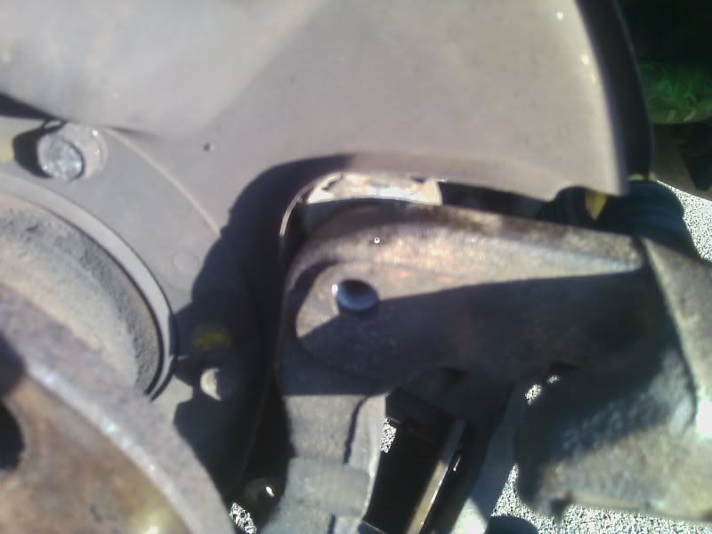

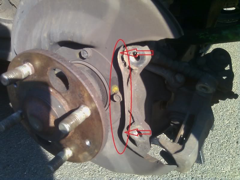

    -With all of your brake stuff off of your hub, you will need to cut into your dust shield slightly shown in the picture (you can easily do this with a flat head and a hammer)
    This is why
    There's not enough clearance for the new caliper bracket.

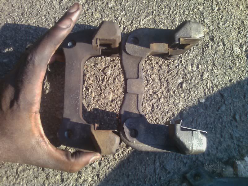

    -Next, install you new EP3/RSX bracket. It should be able an inch longer than you old bracket
    Pics
    (you should know which one is the EP3 one lol)

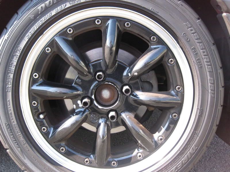

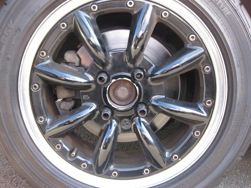

    Before
    After
    Now you are a baller because your Honda has 11.1in rotors in the front and 10.2in rotors in the rear.
